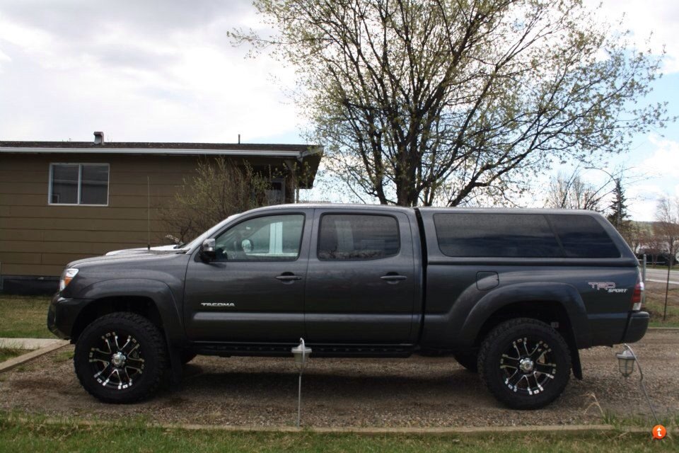

    No need apologizing for the long post lol. I had vibration and squeaking issues when my 3" procomp was initially installed. Didn't do it right away only after alignment. Had the shop look at it and one bolt had loosened, or wasn't retightened after alignment, and was rubbing on the lower left control arm. A little tweaking and tightening and it has been good since for nearly a year. I also went with 18" but the offset wasn't enough to run a 305/60 so I went a little narrower but I hear you on the ride though, definitely roughed it up a fair bit. Good luck with the endeavour! Let us know how you make out

    10-4 thanks for the info. When I take to the dealer I'll mention the bolt issue as the vibration I believe did start not long after the previous service. Nice rig by the way, diggin the topper.
