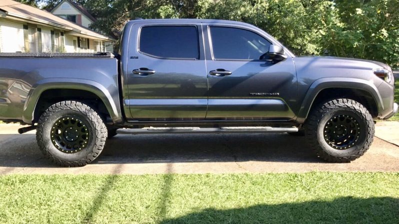

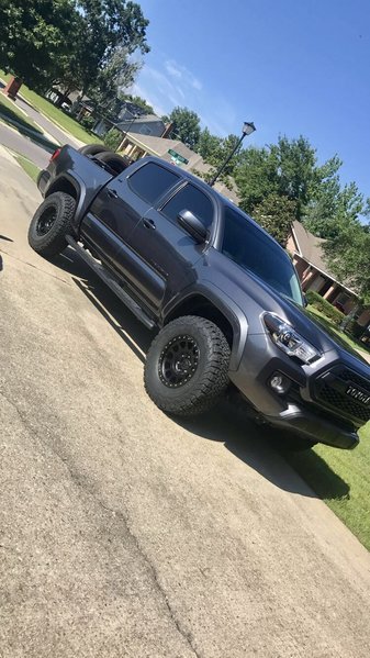

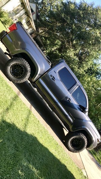

    After a long expensive road of adding a lift and having vibration issues. Finally sold off my lift kit, tires and wheels. Just put on some new ones and couldn't be happier with how she sits stock.
    Only problem I have is when I hit 73 mph on the interstate I get a very noticeable shake in the truck. Is this a wheel imbalance issue? I've already got the ECGS bushing installed to replace the factory needle bearing.

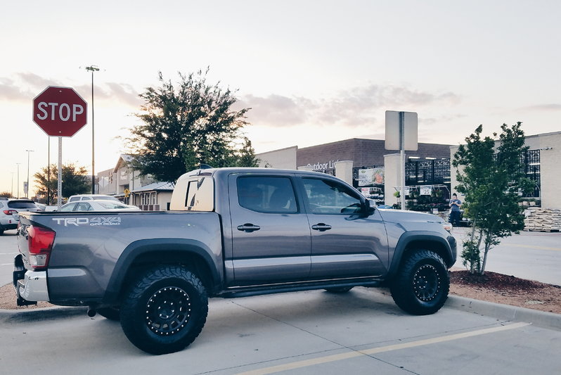

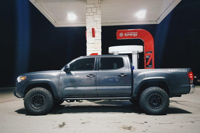

    This photo inspired me 100% I still think yours looks better because of the more aggressive forward lean. Was hoping mine would do the same but it looks more leveled out. I dont know how many times I stared at that damn picture lol.

    Haha awesome! I'm waiting on some funds to free up for the rear lift but we have some 6112s in the garage now waiting to be put on. Heres a recent pic
