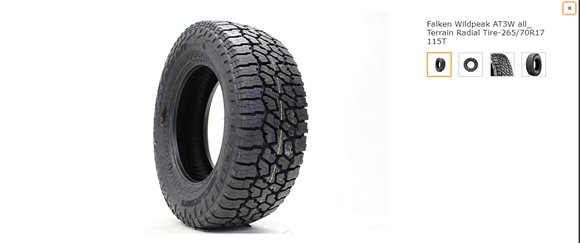

    I never had much luck with wranglers for wear on a couple of trucks I've had. I did buy some of these Falken's for my 2015 TRD Sport. They are a size bigger, no modification needed to truck and they looked and acted well, not loud either. I will buy them again and will once my stock tires wear out. I can't afford to just switch when I have perfectly good tires now or I would. They are actually on sale right now on Amazon $117 ea.
    Falken Wildpeak AT3W all_ Terrain Radial Tire-265/70R17 115T
    BalutTaco likes this.
