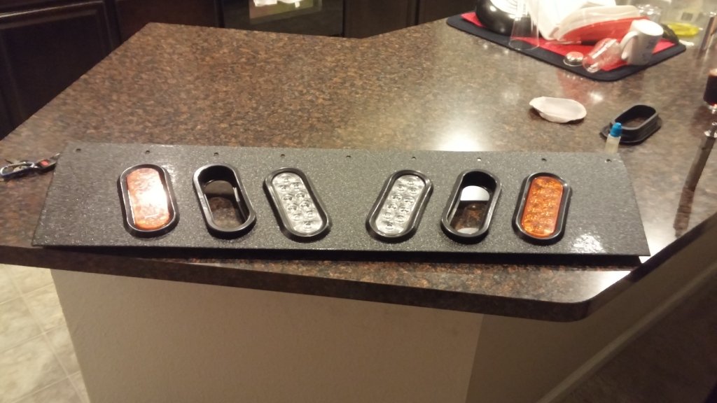

    Well heres teaser shots fenders are just set up there for a pic and the lights are the new rear tail light plate0105151736_zps23c0a390_e96eb8d261d2c0d4dd50f5b767b4491622f7759a.jpg0105151944_zps0373cb38_204da52af19508a4de5a4aaa917105ac75996392.jpg[/URL

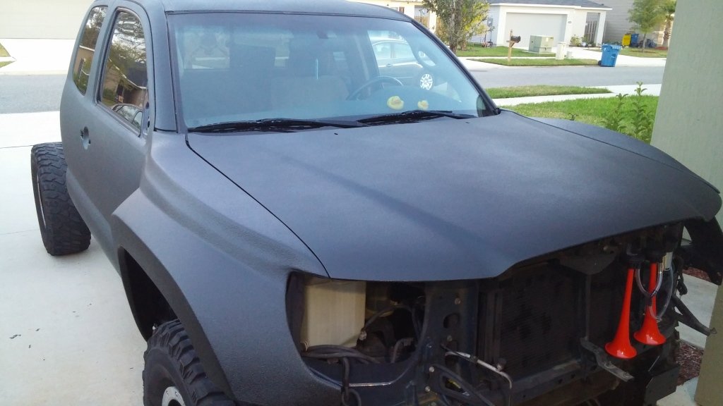

    So far new headlights and grill are in along with headlight trim mirrors and door handles. Bumper is on aswell. Ran out of light so ill pick it back up tomorrow. Going to try and get my skid plate cut tomorrow and get it coated. Only downfall to rhinoline is all the "diddy balls" or slight overspray has to be trimmed and cleaned but no worries its not a show queen is a uh well im not even sure yet lol

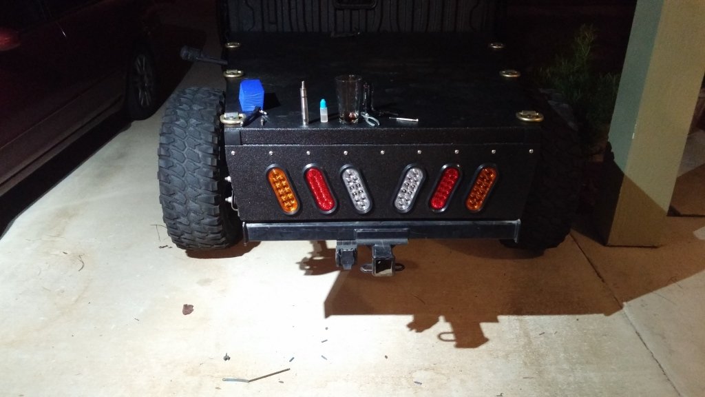

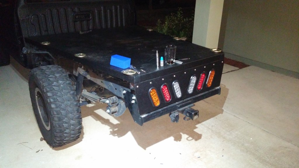

    0106152051b_zpsd15d7c6b_c4113f01e85a2c46a5c5ce0a9d88a4dd827640c0.jpg0106152051_zps1bd0656d_c734f3c76c9718f3befffd88239a21a93a50b003.jpg
    Back ends on aside from tool box and led third brake light Just quick connectored on for now. Tomorrow ill solder and heat shrink all connections then wrap them with sheathing and hid them better. So time consuming i hate wiring ugh
