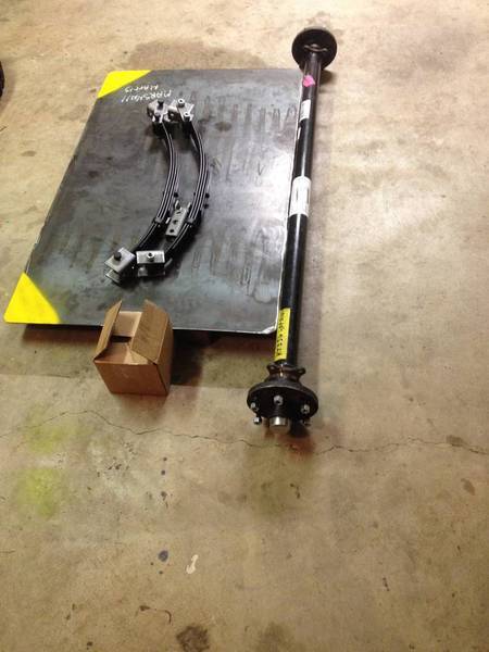

    This is really just a bare minimum start to a not so extravagant trailer, I don't really need that many bells and whistles, just something that can haul stuff in off-road situations.. I have the trailer axle ordered, the multi-axis hitch built, some tires and rims for it and some barrel hinges for my doors and such. The axle is a 3500 lb axle with a 63" hub-to-hub width and 6x5.5 lug pattern to match my wheels. I got the axle from a company in Dallas called SouthWest Wheel Company and they had a package deal on the axle and all mounting hardware needed for a good price.

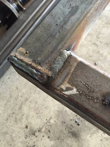

    Well I finally had some time to get some work done on the trailer. Made some decent progress but I still have a ways to go. As a forenote, I'm using my 110v hobart for all of my tack welding and then my 220v stick welder to fully weld everything.
    All the metal for it

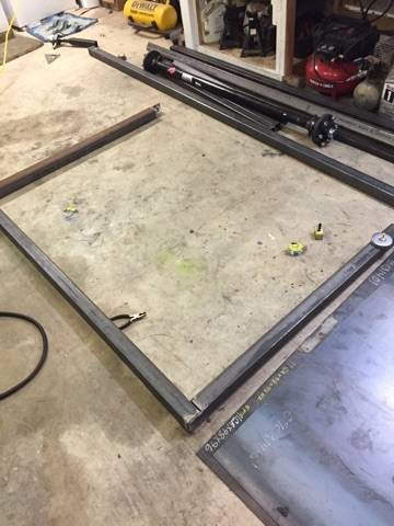

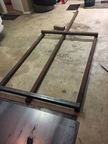

    Cut my pieces just to get a rough idea on the size of it.

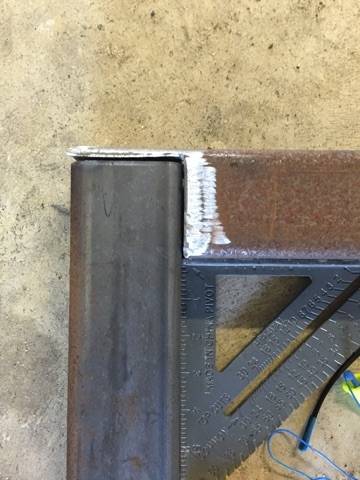

    I decided to cope the ends rather than cut angles on them. Not sure the pros&cons between the two but I have built alot of stuff using that method so I stuck with it.

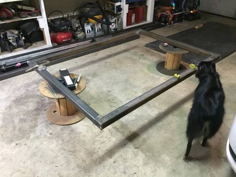

    I tacked it all together and welded it up fully, had to have my inspector make sure it was up to par.
    Not to shabby..I think, I'm no pro at this stuff. I did a root pass with 6011, two passes over that with 6013 and capped it with some 7024. Should do the trick.

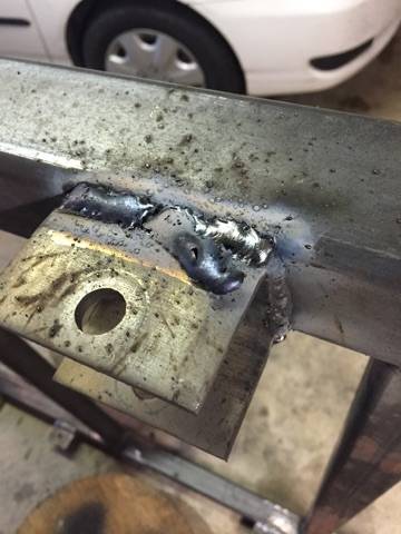

    And the last thing I got accomplished was getting my suspension laid out and my front hangers fully welded.
    I think they say you know it was a good weld when the slag peels off?

    Thanks! I had a bit of a hiccup lastnight with the springs, I mounted the rear hanger to far outward instead of inward :frusty: had to cut the damn things off and make new ones.

    Haha man, lucky, I didn't realize till I had already fully welded it, that was a PITA to get off. I plan to just stitch weld everything and then go back with seam sealer. That would be a whole lot of welding.

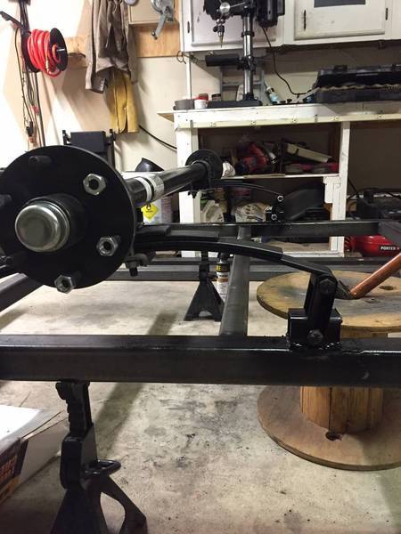

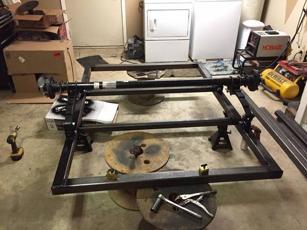

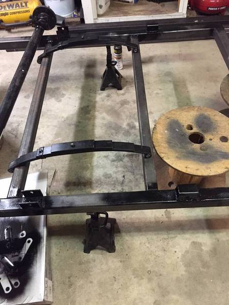

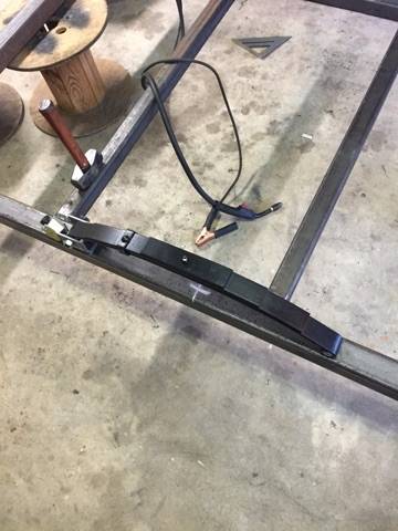

    Got the rear hangers fully welded in, dont mind the ugly semi-gloss paint, just trying to keep it all from rusting for now.
    The angle looks good to me, any experts see anything wrong with this before I start hauling it down the road please? I think its at about 12 degrees.
    Got the spring perches welded on the axle and bolted it all just to test fit. Next step is the tongue :cool:
