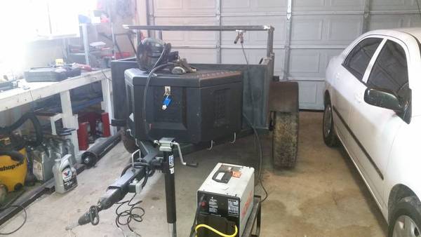

    Well I made a ton of progress on it the past 2 weekends, now its just time to finished painting it and build the rack for the top of it.

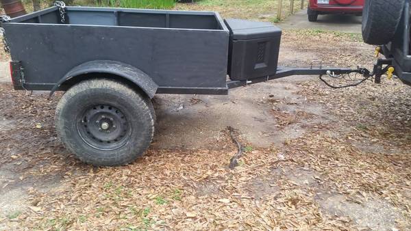

    Got the toolbox mounted using U-bolts around the tubing and up through the bottom of the toolbox.

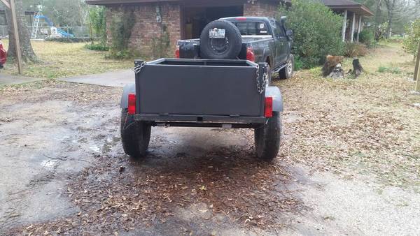

    And here it is with the fenders and lights mounted and the whole thing primed. Did a test drive with it and got to 75 and it tracked like a dream.

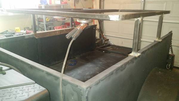

    Now the only thing left is to bed-liner the inside of it, put one more coat of paint on the outside, build and mount my RTT rack and make that rack removable/hinge on one side. I debated on building a lid for it but right now this should fit all of my needs.

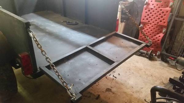

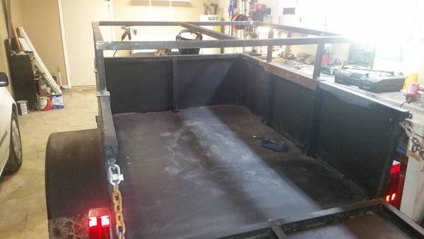

    Been stupid busy, got some things done though, still haven't bed lined it yet.
    Tailgate is done, made simple latch assembly to keep it closed, used some pretty hefty chains, probably too big, and used some quick connect in case I ever need to drop/remove the tailgate.
    Started on the tent rack, once Im done it will be able to be removed and also lift open to the passengers side in case I need to get into it from the side: the hinge system should server me well if I ever decide to put a lid on it.

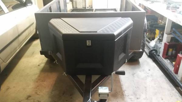

    And here is a sort of front shot just becasue, you can see how the fenders cover the tires perfectly
