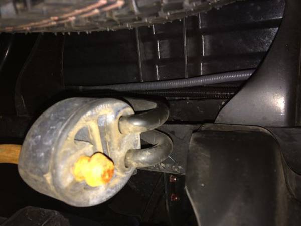

    I was originally going to do this as a tutorial, but as it turns out, its allot of work to do those. Instead, I'll show some pics I took along the way and at the end. I bought this marine 12v outlet off eBay months ago. I'm tapping into the fused, always-on power source from the outlet I added to the center console in a previous mod.

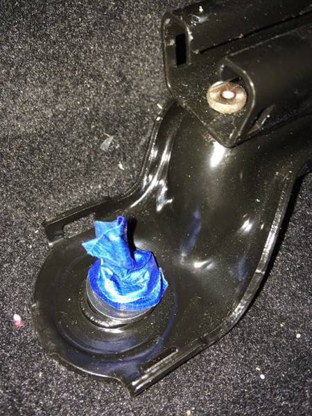

    Maybe my sockets are crap but the 14mm had some slop and I can't stand scuffed up nuts, so here comes the painters tape;

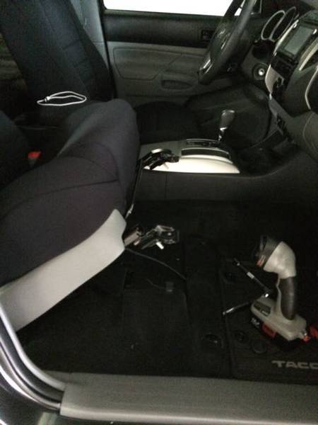

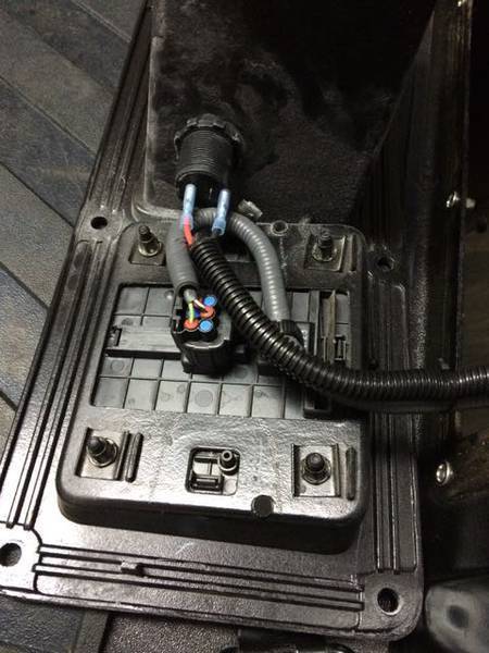

    I thought i'd be removing the seats but I only needed to remove the bolts and tilt the seat back to gain access to the floor plug;

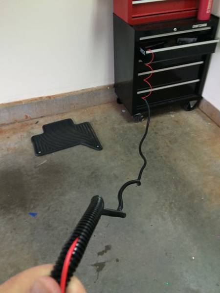

    Prepping wire and loom;

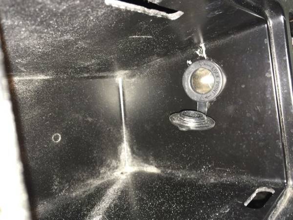

    I didn't get any shots of me drilling a hole, but here is the back view of the outlet installed;
    From underneath;
    and another;

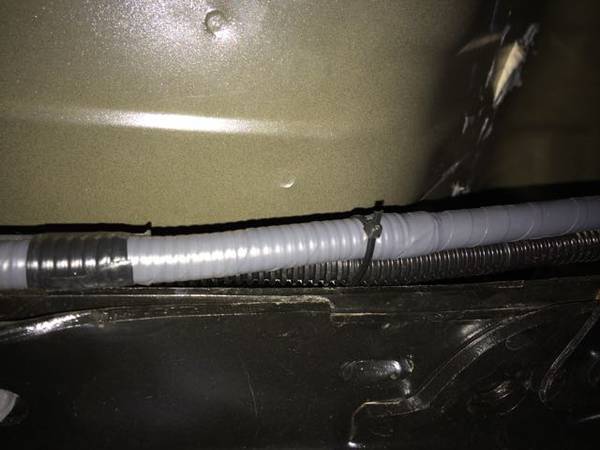

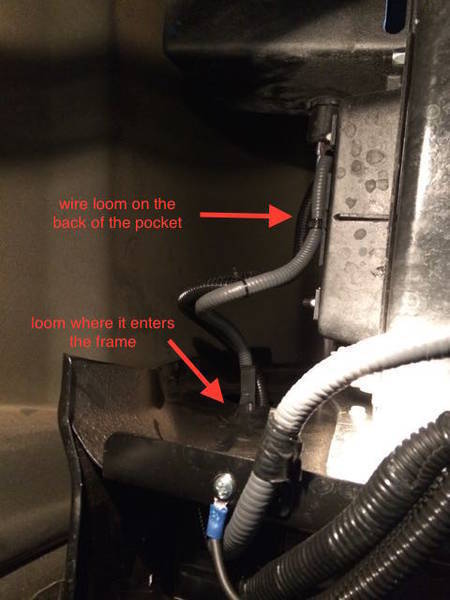

    And some shots of the loom running along side a factory loom;
    And another;

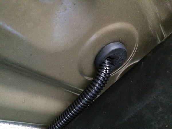

    And through the floor plug;

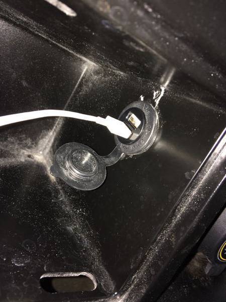

    Installed Pic;
    In use;
    That's it. I have to say, i haven't found a use for the 120V outlet yet but these always on 12v outlets are a must for a family with iPads, hotspots and phones.

    PS: Some of you may notice that white line above the outlet, looks like a scratch or a crack, well thats a crack of sorts. Turns out the inside of these bed pockets are lined with a sort of laminate. When drilling behind and applying moderate pressure, it cracks. If I had known, i would have applied less pressure and allowed the bit to do more of the work. Since this mod is inside the bed pocket and faces the front of the truck, I don't think anyone will notice this.
