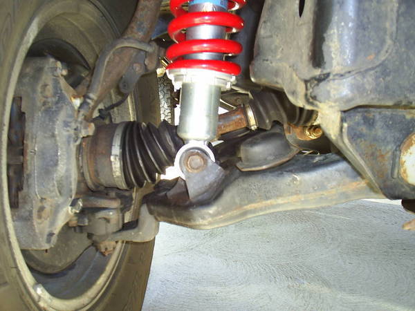

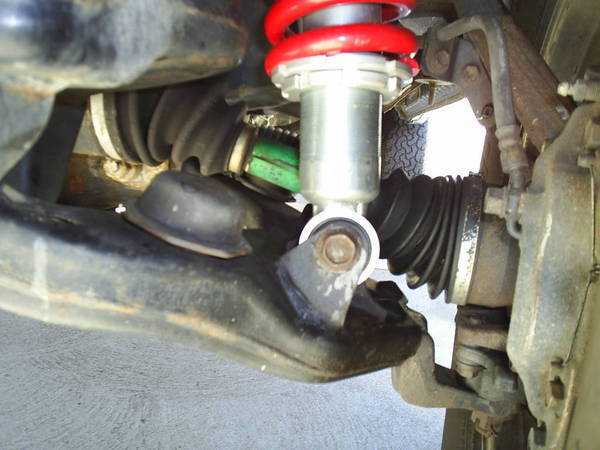

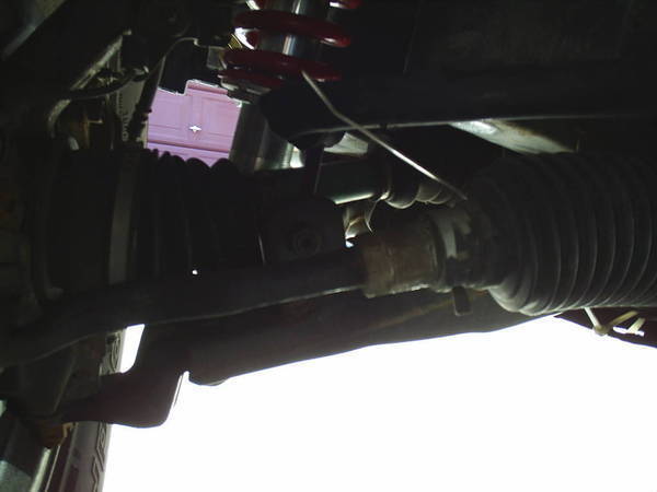

    Heres some pics of the CV boots

    Did you do a diff. drop? If not, I would! you got alot of angle on those CV's. a few fins are touching.

    your angles look steep did you drop the diff?

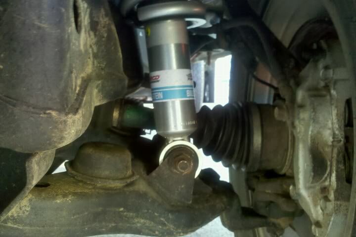

    Here is how mine looks with the Diff drop It's still a little steep for my taste but at least none of my fins are touching. If you didn't get the Diff drop kit buy one.

    I do have the 1" diff drop installed...the front of my truck is higher than the rear also...

    I would spin the shocks down a little to help out on those angles a little. How much lift did you get from stock?
