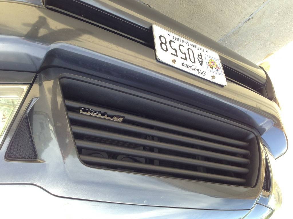

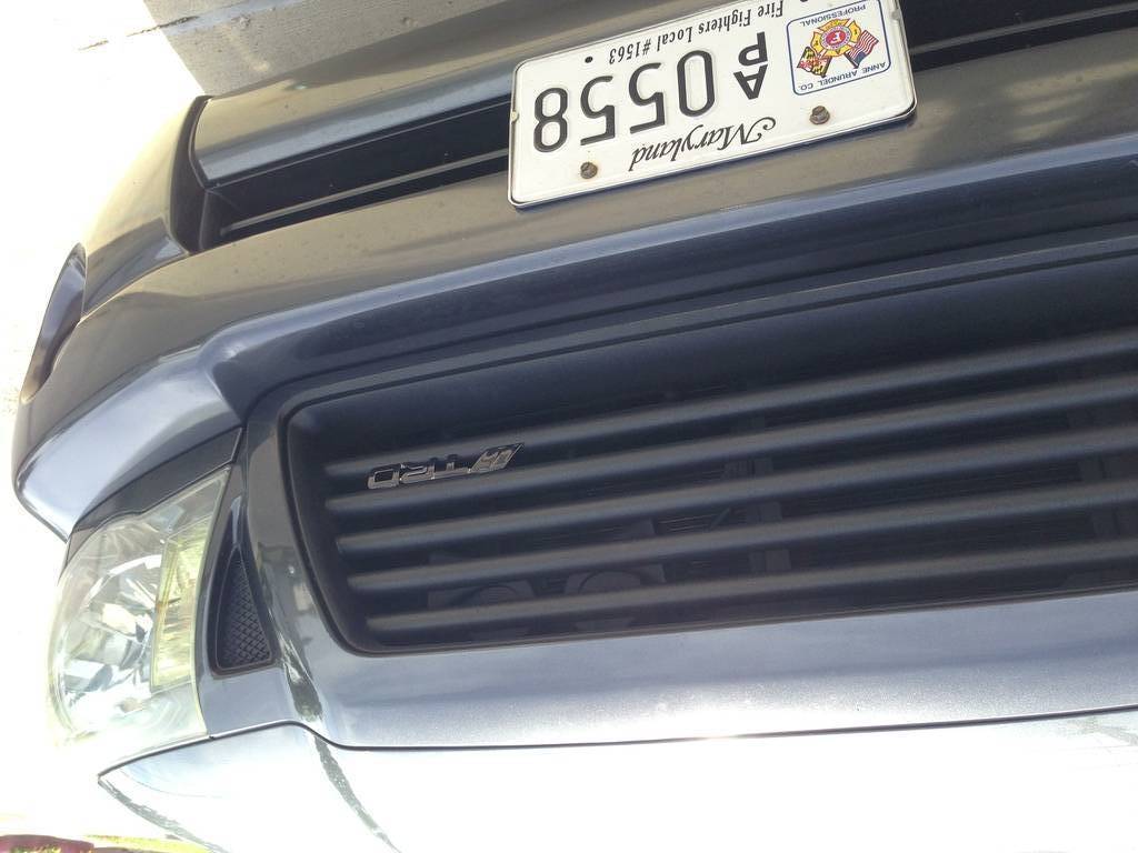

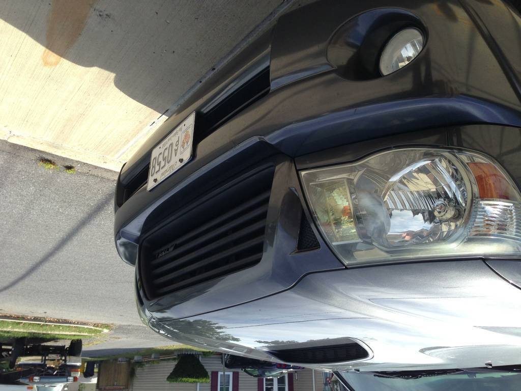

    I've been thinking this up for a while and finally got around to do it. It took me around 5 hours. I used EMT tubing and painted it all with the spray on bed liner. I'm happy with it.

    I extended the sides with the fiberglass kit then drilled the holes with a 1" hole saw. Cut the piping to length and painted to let dry. Then slid the pipes in and epoxy in place. I filled in any gaps on visible side with black silicone and then painted the entire grill again.
