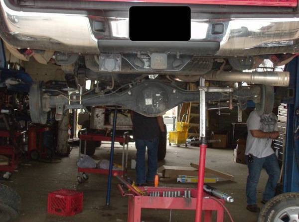

    AAL being installed. Can tell the difference right away :)

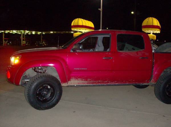

    After lift with old tires..

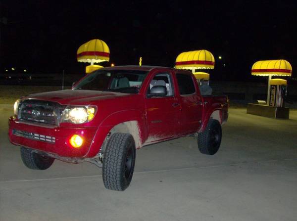

    And after the new tires. was already dark :(

    Hey man! I'd like to see some pics during the daytime, and with the front tires pointed straight ahead. I'm kinda thinking about some BFG a/t's at 285/70/17s. I already have a 2.5" lift. Did you have to do much trimming? how do you like them/how the truck looks with them?

    Ill get some pics as soon as the weather permits. I had to do minor trimming in the fender, but the LR UCA's were the only reason I didnt have to do cab mount chop (even though I will at a later date for added clearance while flexing). I actually only yielded about 2.75 inches from coilovers because I wanted to maintain the ride quality and didnt want to stiffen the eibach springs anymore so the 2.5 inch should fit with some trimming. However I wouldn't reccomend too much negative offset, as that will push the wheel out (which looks badass) and cause more rubbing.
