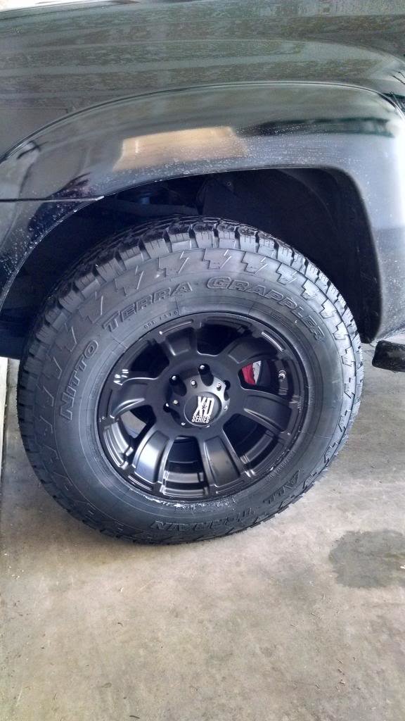

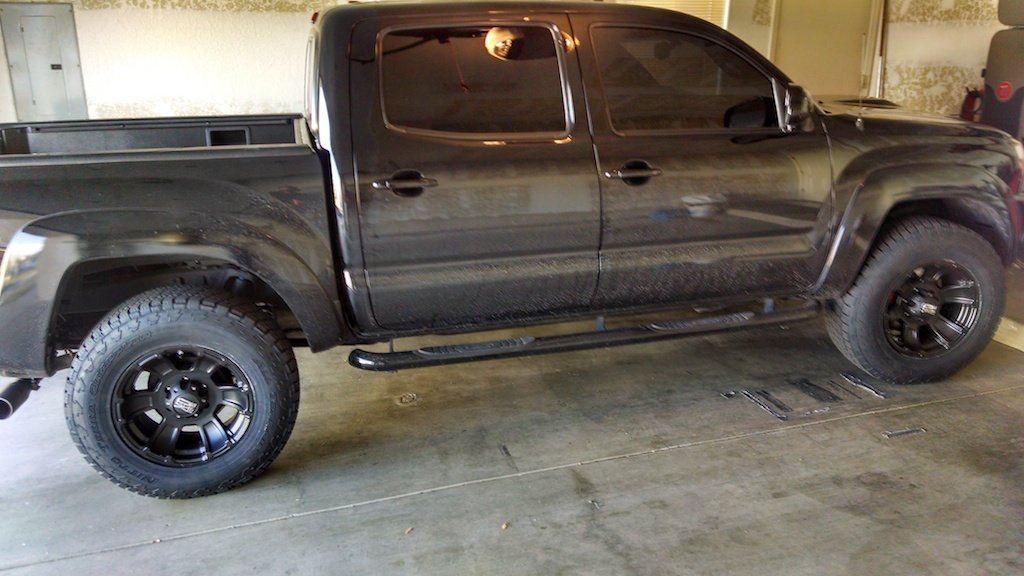

    I've been planning to get new wheels when the stock tires ran their course, and this week it was finally time.
    I don't have a lift, so I went with 265/70/17 Nitto Terra Grapplers on KMC XD Revolvers. I need to do a tiny bit of trimming up front, but the look is MUCH improved.

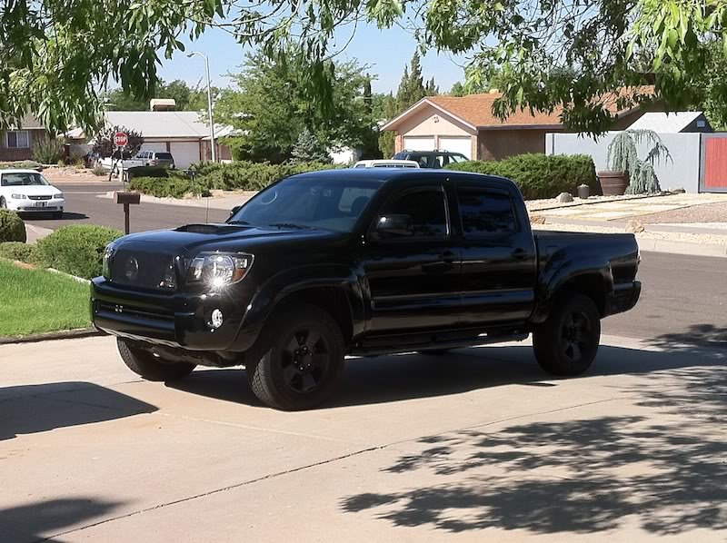

    Before w/ painted stock wheels:

    AMCQuary- I have the same truck but a '14. I like what you've done. What's rubbing up front? I do see that you pulled off the factory mud flaps... Did you go 17x8.5 or 17x9". Also, do you know the offset or backspace on the wheels? Thanks John

    17x9, -12, 4.5" BS

    Same exact wheels and tires that I put on my '11. I had to trim the inner plastic but was able to leave the mudflaps on with this set up.

    I had to trim the inner plastic part of the front fender well, behind the bumper, the tires were rubbing a little bit at full lock. It was a 5-minute fix.
