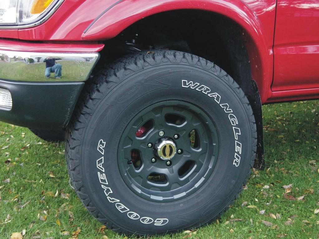

    Here's a pic of same (size) tires and clearance with a 2.5" lift, I think they'll clear fine, just might rub on a hard bounce and corner at the same time. I went with 3" lift after these pics were taken, just to avoid the occasional scrubbing (like turning into a driveway with deep gutter).

    Thanks for the pics. Yeah, I know I'll need longer shocks. I was thinking the Billys. What is the backspacing on those rims.
