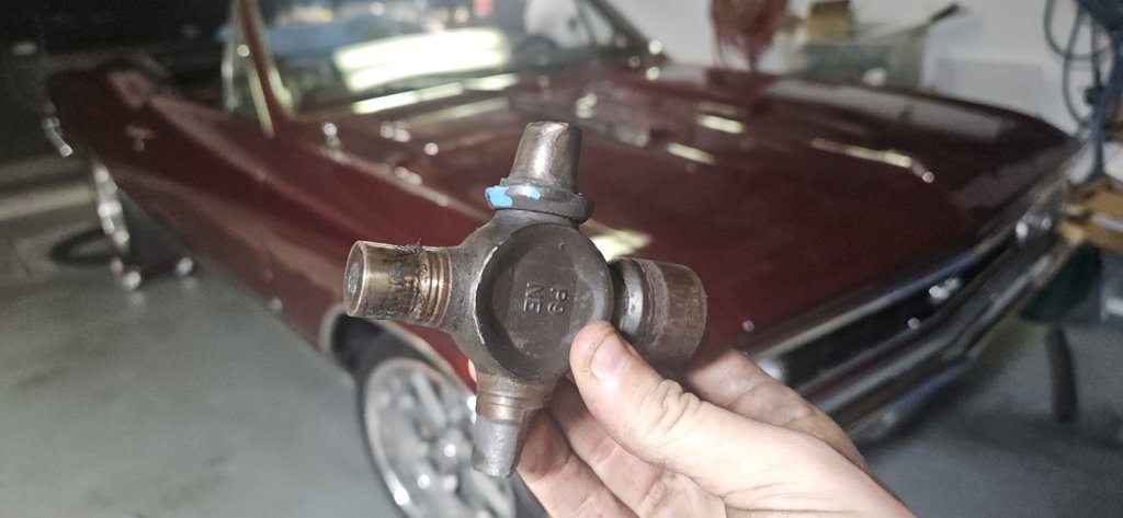

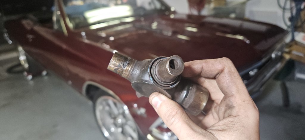

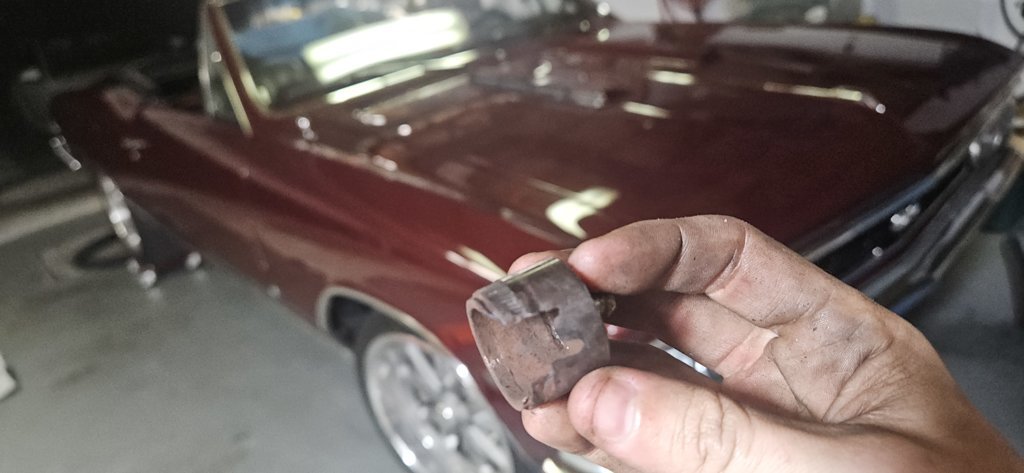

    Been having some crazy clunking grinding and squeaking for a little bit. I replaced 1 u joint when I bought the truck, neglected the other two...
    Finally got a free day off of work to do the remaining 2 u joints and the center support bearing because it had gotten so bad. Here some pics of the ones I pulled off the thing.
    Ended up with a spicer 5-1330 greasable and a spicer5-1330 ungreasable. Both fit great. For the center bearing I saw so much conflicting part #s but
    Spicer #211750-1X fits the 4wd from what i found and it fit perfect on my truck :)

    I think it's time for proper use of this smiley/emoji: :eek:
    You got your money's worth out of those and then some. Glad you got them replaced before anything catastrophic happened. Good lesson for everyone about benefits of preventative maintenance!

    Holy crap... did you never grease the joints? Going on 170k on my 2013 with its stock u joints and they get a few pumps of grease every oil change. Zero slop.
