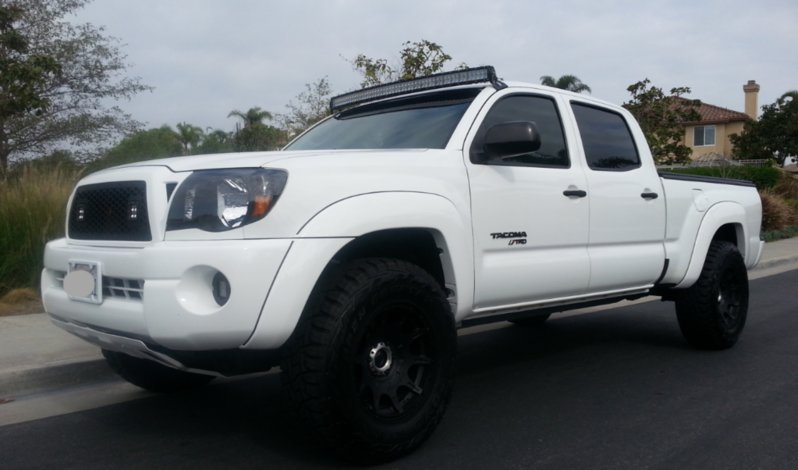

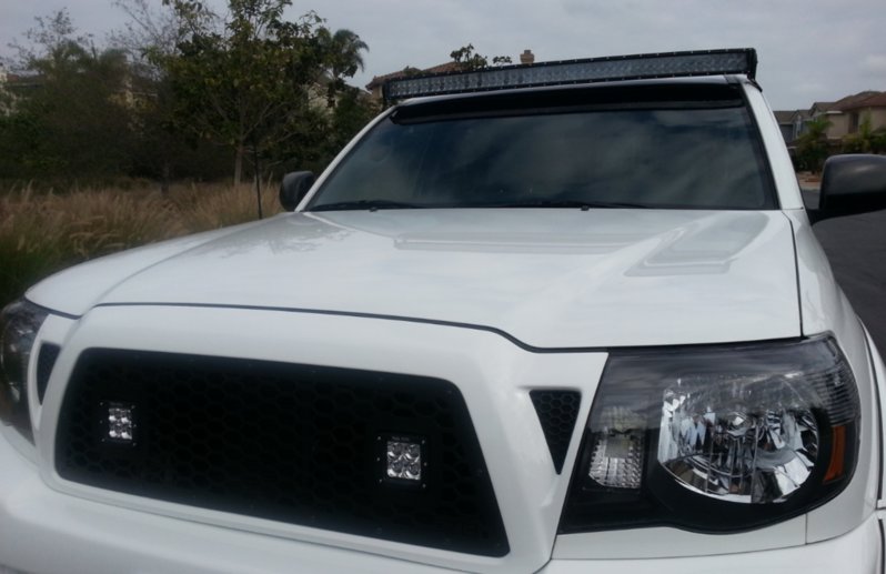

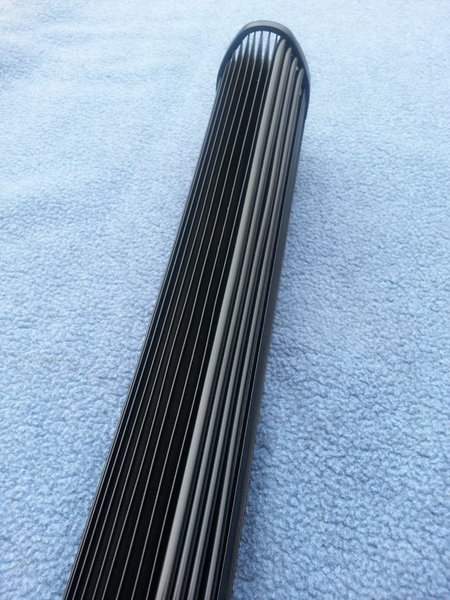

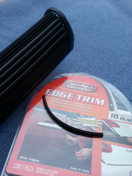

    Added my windshield light bar on Saturday, then spent Sunday getting rid of the screaming wind noise which started at 20 mph, then was deafening by 45 mph, made the vehicle un-drivable. The door trim mod on the bottom side heat fins took away 95% of the noise, very happy now!
