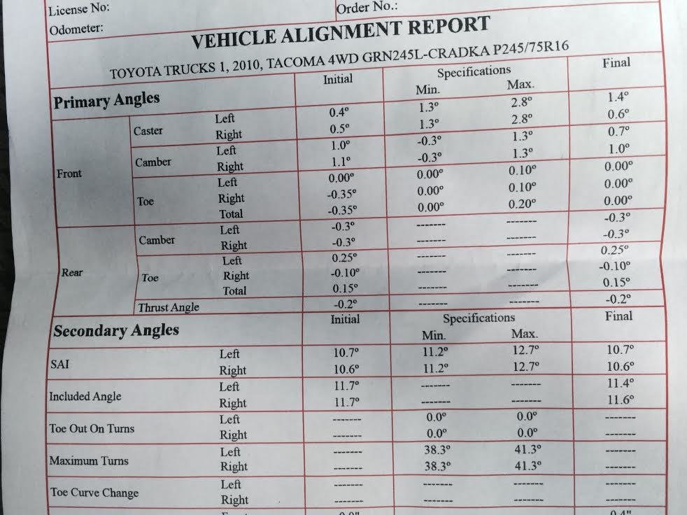

    6112 Front Suspension, Fox 2.0 Rear Shocks, Nitto Ridge Grappler - LT285/75R17 C, Rear Blackout Tacoma Badge, De-badged, Icon Rebound Wheels, TRD Grill Gights, CBI Ditch Light Brackets w/ Baja Design Lights, Husky Liners, JBA UCAs, Geenlane Off-road Sliders, Tacotrooper Decal, DuraBump Rear Bump Stops, Pro-clip USA Phone Mount
    ^ caster is too low. "Caster you want as much as you can squeeze out of these guys IMO, I think about 3* is a good number. This will dictate how your truck handles, too little caster and your truck will feel like it's 'floating' and following grooves and ruts in the road, wandering etc... too much and it makes it more difficult to turn. I'm of the opinion that you'll never seen enough caster on these trucks to make it an issue." To achieve this you would need after market UCA's.

    00 AC, 08 DCSB, 11 AC,15 DCLB, 16 DCLB,17 DCSB
    I wasn't expecting perfect, truck handles fine for what I need it to do, haul dirt bikes. I was just making the point that you can run factory UCA's and only be off on caster (in my case the right).
    I'm not knocking what you did. To each their own, but for OP question imo anything over 2.5" I would strongly recommend aftermarket UCA's.

    Extang Trifecta Tonneau WeatherTech Floor Liners Pop & Lock Tailgate Lock Antenna X Black Mesh Grillcraft with Tacoma Badge (Upper) and Cross (Lower) 18" BMF Wheels / Cooper 31.5" Tires 2" Leveling Kit
    I have a 2" leveling kit and the tech said that the alignment had plenty of adjustment left with stock UCA's.
    Can't answer your 5100 question with first hand experience. I just have a top plate spacer lift. If I were to do it all again, I'd still do the top plate spacer kit.
    Roger, sorry, easy to get on defensive sometimes on here. Thanks.

    Work in progress, but mods so far; OTT 7.0 tune, 255/85/16 Falken WildPeak M/Ts
    x2. Even the low end of spec on caster sucks for a daily driver.

    3" Lift with UCA, Grillecraft grille, XD rims w/ 285/70r17 duratracs, leer xq cap,
    This happened to me with my 3" thought I could get away with stock UCA and she wandered all over ended up with new UCA
