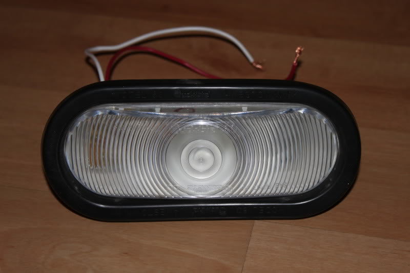

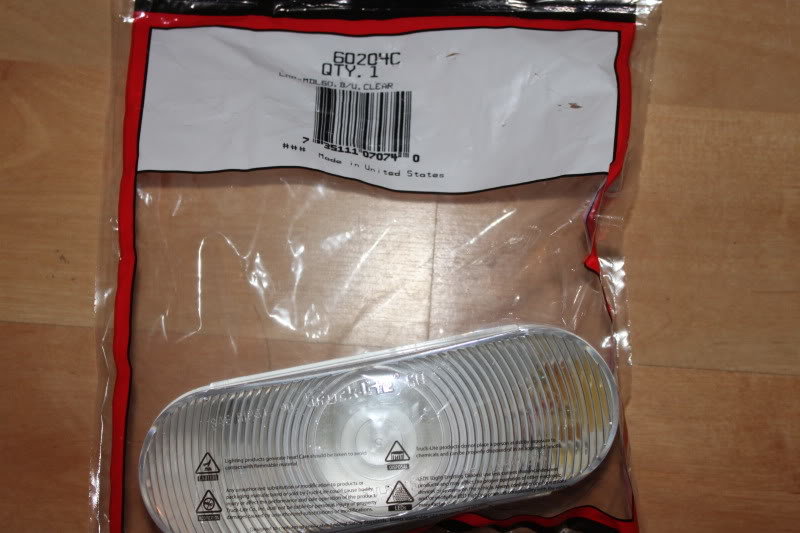

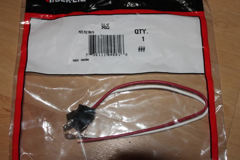

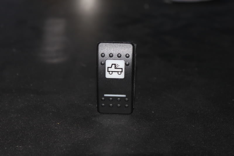

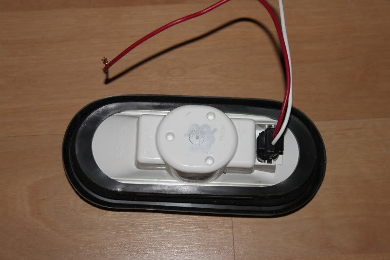

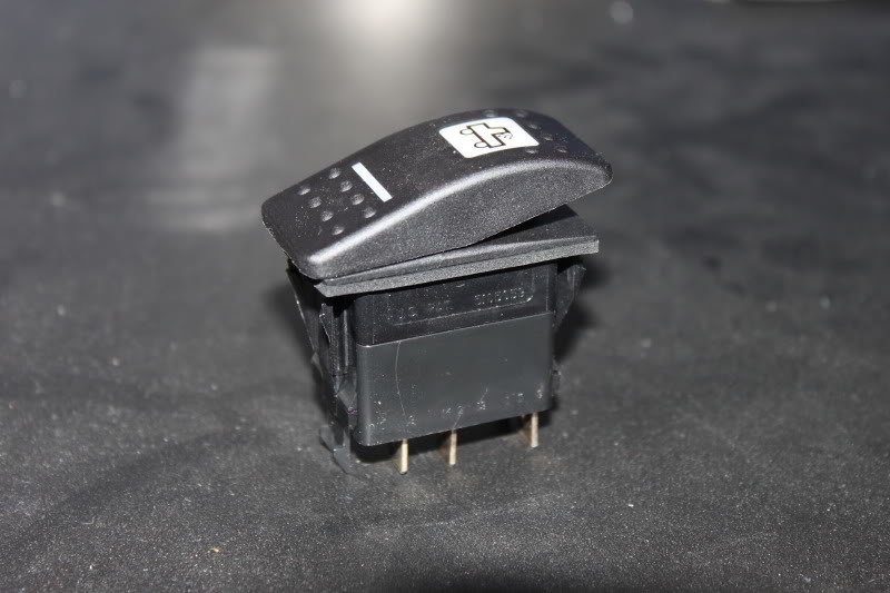

    So i finally started working on my bed light mods. Been looking at different alternatives for a while and i've read a lot of write ups but i haven't liked any of them. I decided to come up with my own. I found a carling bedlight switch on carlings website and after about a month of searching for it on-line Mud-UK was able to get one for me in red like i had wanted. So then it was on to bed lights...I looked around for about a week straight and finally found some flush mount 12v reverse/back-up lights that i thought would work perfect.

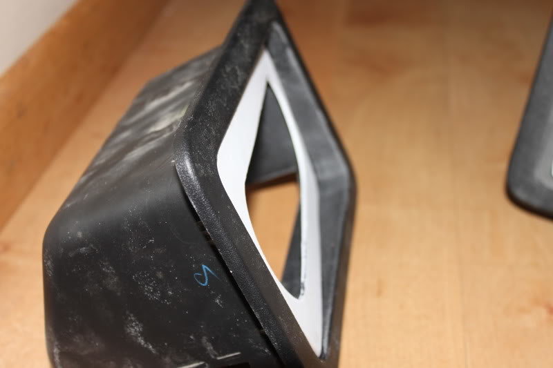

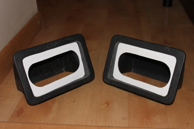

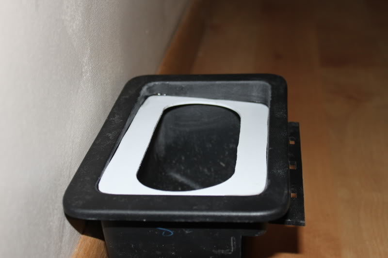

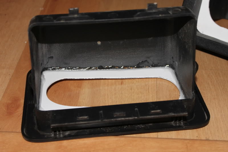

    Next i took a hard piece of plastic about 1/8" tick and jut it up with the jigsaw to fit the side bed pockets. I tried using 1/4" wood but it just kept breaking as the one end had to be very thin for the way i wanted them mounted. I used lock-tite 5min epoxy to glue the plastic pieces in place.

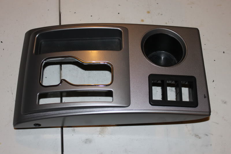

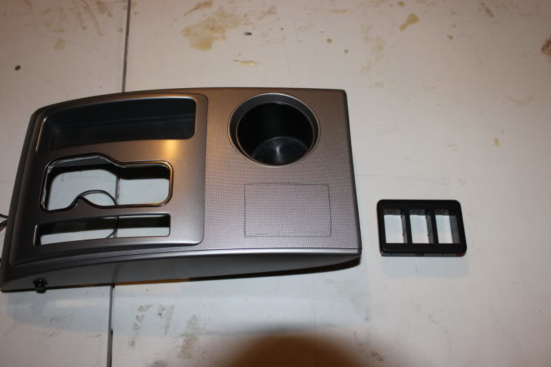

    So then i sanded it all down and dropped them off at line-x and that is where they sit until tomorrow evening. I also mounted a carling 3 switch blank in my center console that i will use for bed lights, off road lights, and a cb radio. I dropped the center console off at line-x as well to get sprayed. I think it will give it a nice look for the rest of the cab, too much silver in there for me.

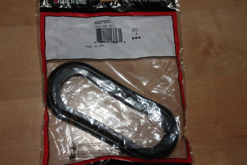

    The light, gromet and wiring plug
    Here they are for part numbers and brand
    My bed pockets modded, before line-x. You can see that i angled the lights both back and down to illuminate the entire bed.
    The best part of these lights was the total. Everywhere i found these lights on-line they were 30 bucks a piece + the plug and + shipping
    My carling bed light switch
    Here is the 3 switch panel i installed in my center console as well
    So, the center console and bed pockets are at line-x right now and i'll have them back tomorrow. I'll take pics when i get them back and install them.
