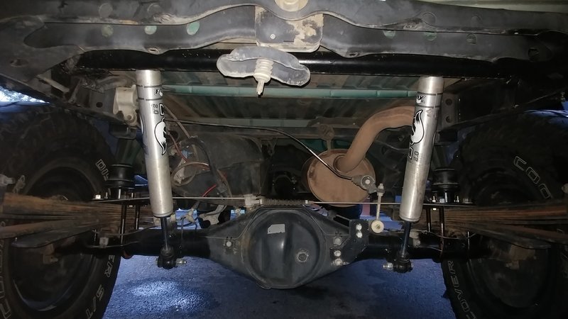

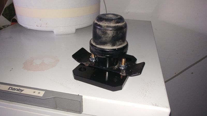

    Changed the oil on it and I finally got the rear all dialed in and buttoned up. Drilled 3/8" holes, 2 on each u bolt plate for my bumps. Used grade 8, 3/8" bolts with serated-flanges nuts. And finally painted the u bolt plates and u bolts. Also put new LBJ's on but I messed up the bolts on my outer tie rod ends hitting them with a BFH trying to get them out of the LBJ so the truck has been on jackstands since yesterday and will be until tomorrow. Local toyota dealership price matches me to camelback toyota parts plus one day shipping most of the time. Also trying to find a place to put the twin ARB compressor. Other than that, it should be about ready for summer trips! :bananadance:

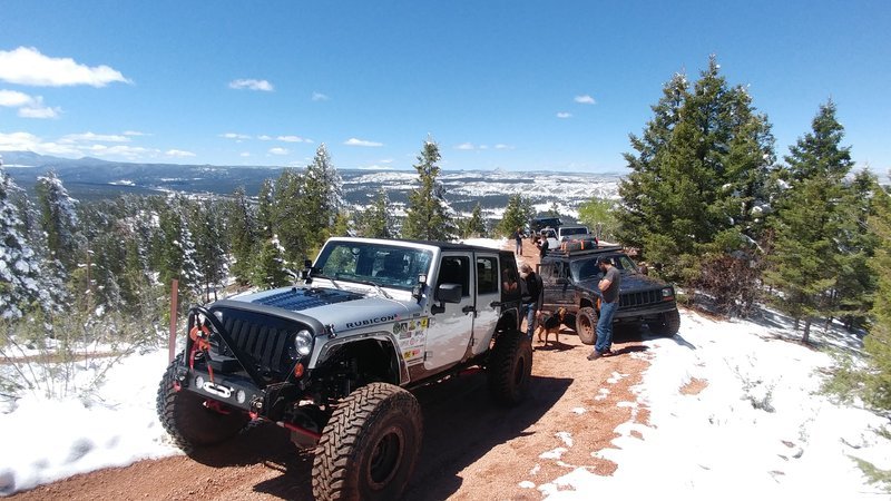

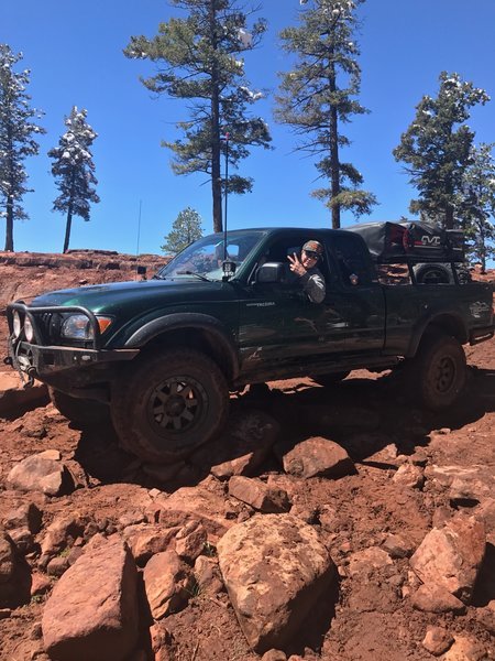

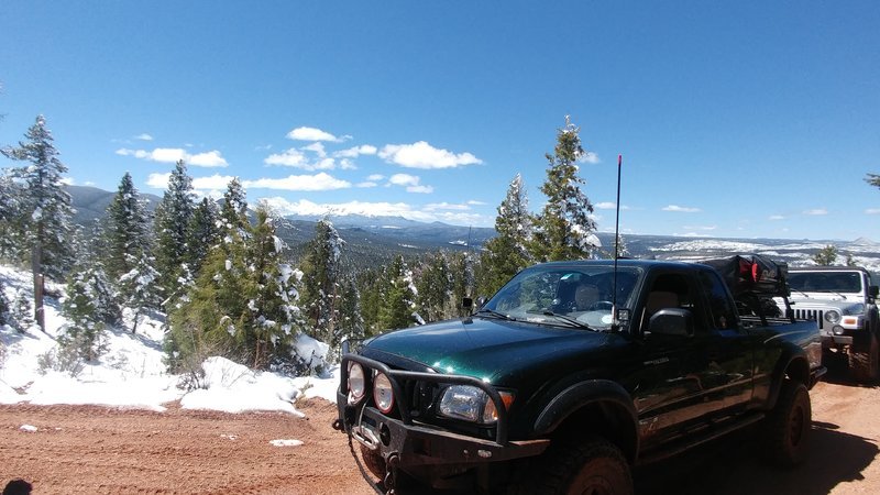

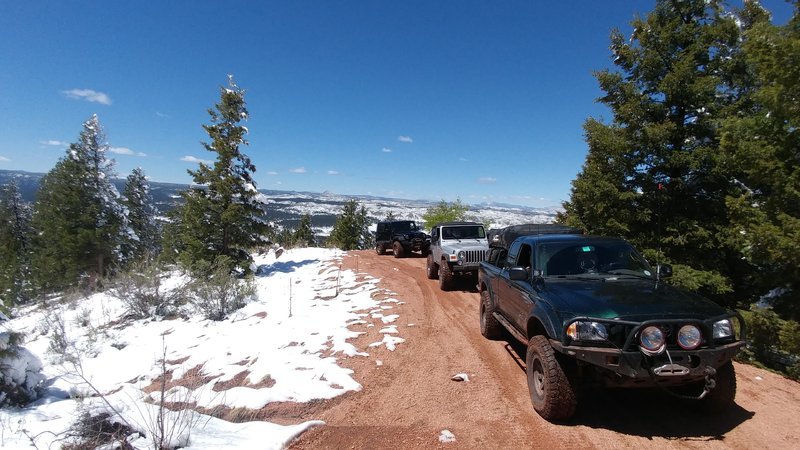

    Got the outer tie rods in and then drove 2 hours to wheel Illinois Gulch in Woodland Park with a bunch of heeps. A jeepster commando with a 5.3 vortec and 40's. And a JK which was equipped with 40's,10.5 rear sterling and Dana 60 front. Hate to say it but it was badass lol. It was a good time and I finally used the sliders and smacked the rear of my driveshaft but its still balanced so we are all good lol.
