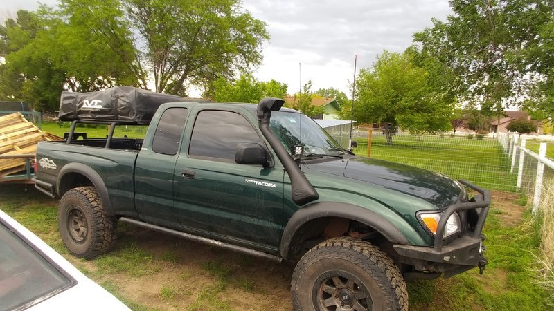

    Fixed my blown cv boot with another Off-Road Solutions High Angle Boot. And jumped on the bandwagon...:yes:

    It was straight forward. Had to cut my ditch light bracket though. Didnt feel like taking off my fender and stacking washers under the bracket. Measure twice cut once lol. The top stud on the snorkel is a bitch to get to with the nut. Unbolting the bottom fender bolt helps though. Overall its pretty simple.

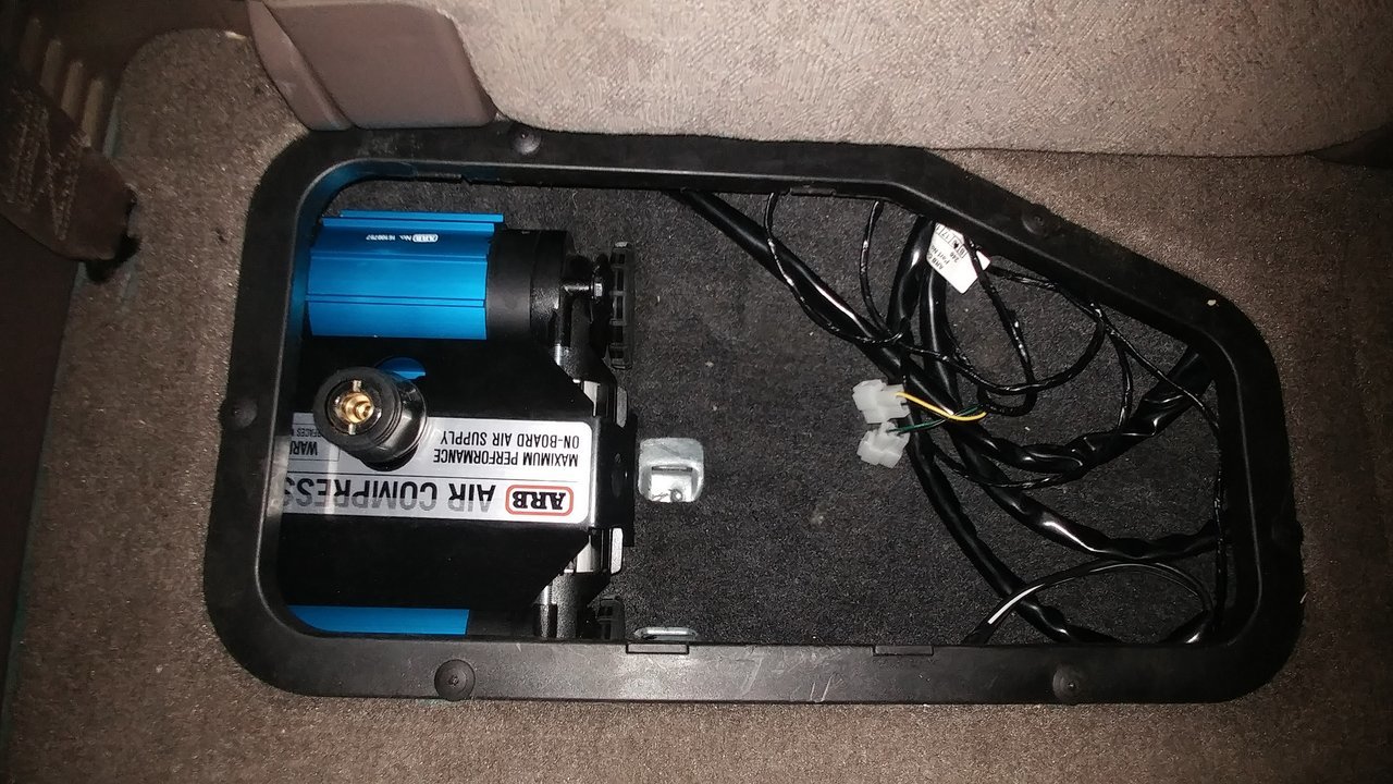

    Well I havent hardly wheeled at all as ive been working my ass off landscaping to pay for college but I did go camping this past weekend which was a nice getaway.

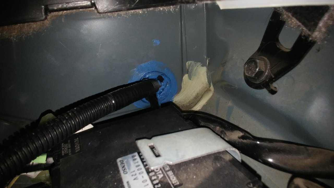

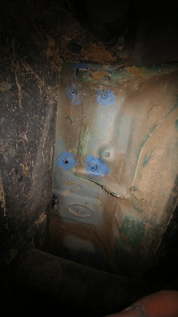

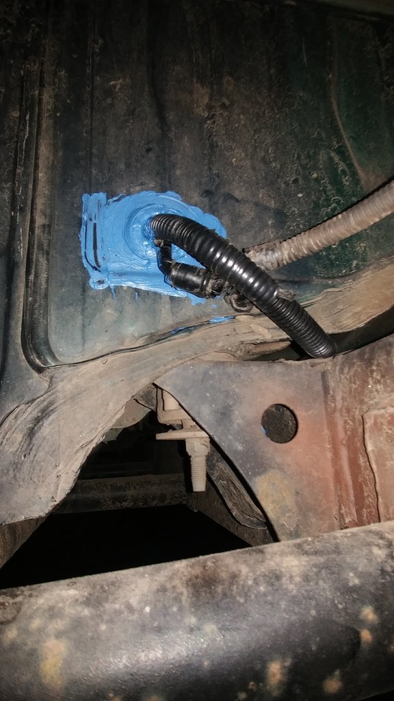

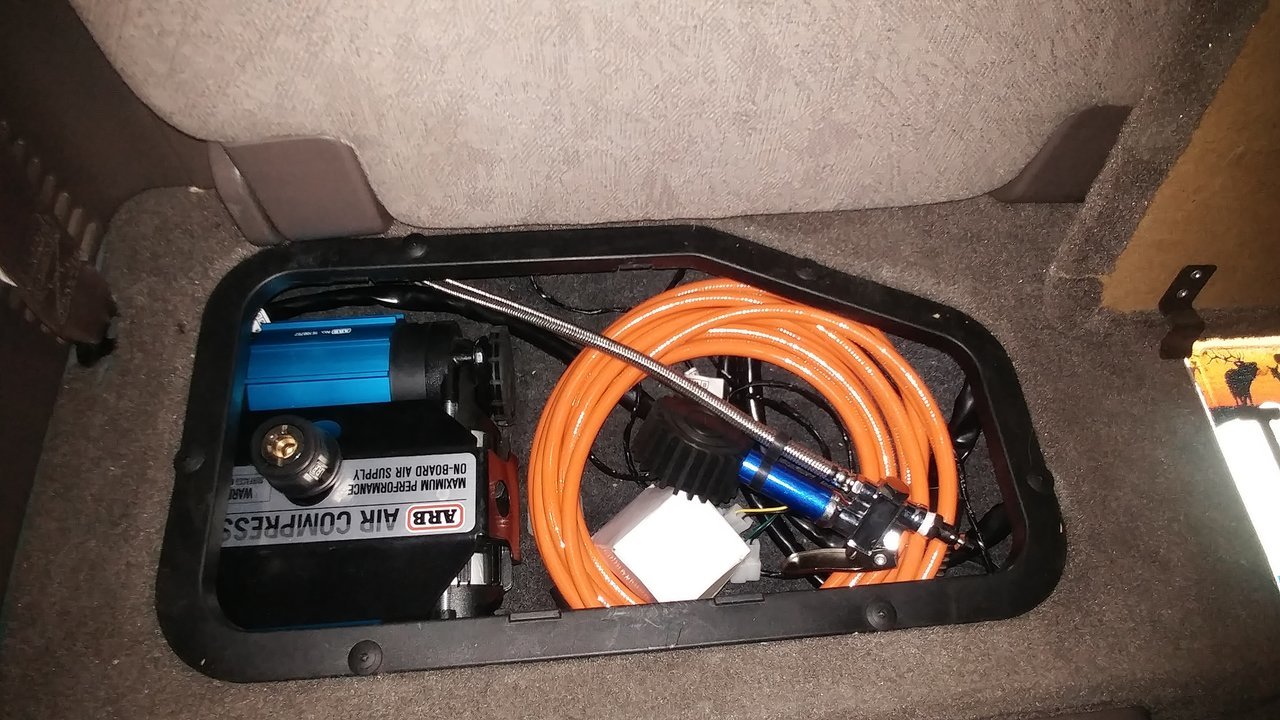

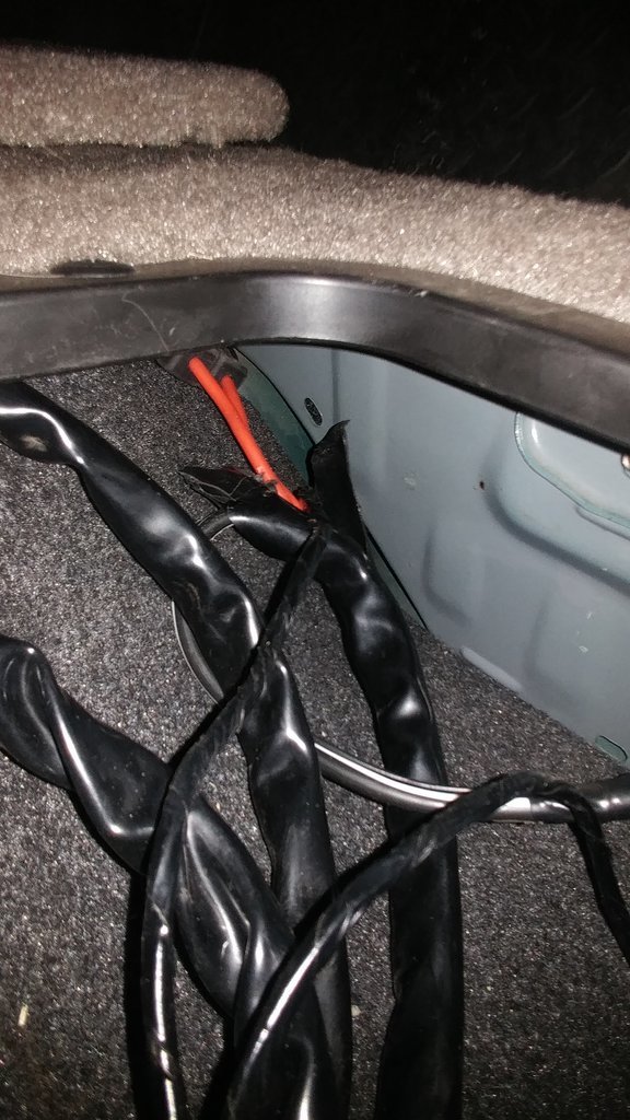

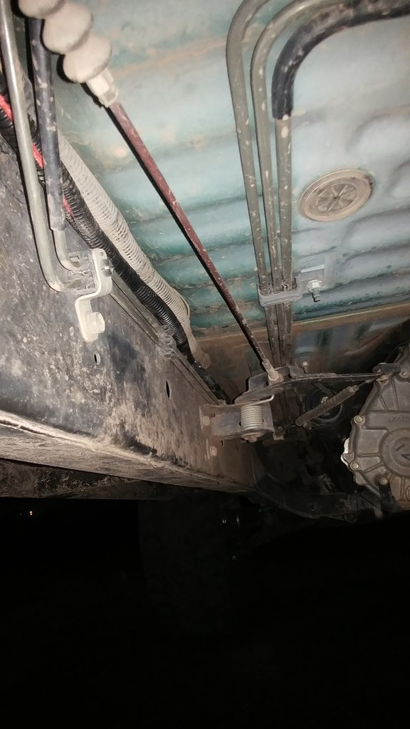

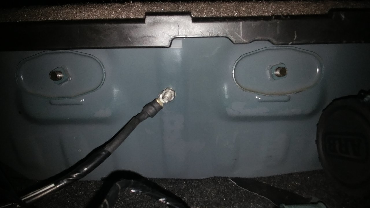

    And then I finally installed by ARB Dual compressor! The whole install I gotta give credit to @SeekingZero as he helped me plan it all out. Thanks bud! Anyways, it went into the passenger side jump seat cubby and fits like a glove. Drilled 4 holes from the template it came with and also reinstalled the carpet in the cubby to suppress/absorb vibration and sound. I grounded the two black wites in the cubby witha new bolt through the front of the cubby. Then ran yhe power wires to the opposite cubby and out the grommet in the back. From there I ran it down the frame and up by the brake lines/booster. Then ran the switch wiring up the center of the truck by the console to my Paranoid Switch plate. It was quite a bit of tedious work but it was worth the clean install. Planning on using some extra compressor hose I have laying around and running the quick disconnect to the rear bumper so I dont have to get in the truck and hook shit up especially if I have the cab loaded with camping stuff.
    20170709_221822.jpg 20170709_221859.jpg 20170709_221940.jpg 20170709_222001.jpg 20170709_222039.jpg 20170709_223813.jpg

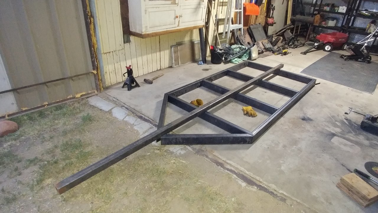

    And ive also been working on this to haul 4 wheelers and leave my tent setup on longer camping trips where wheeling is necessary and I dont have to pack up the tent...:spy:

    Nice work on the ARB install. Glad it worked out well for you!
