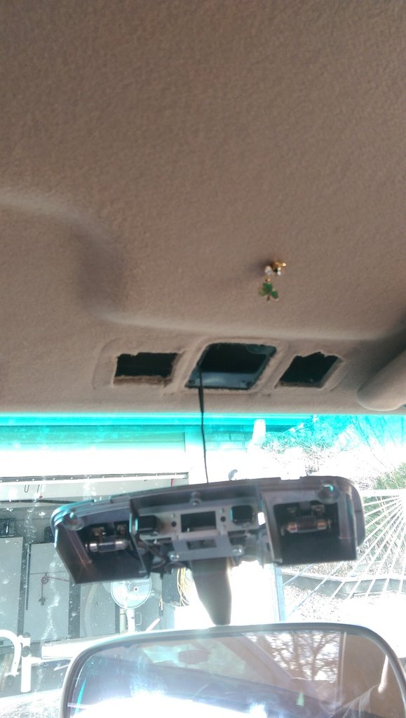

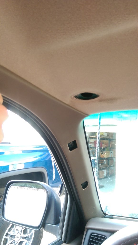

    Then I installed my map light by cutting some really shitty holes in a perfect headliner but meh...tapped into the wire that runs to the dome light. Tapped in behind the top of the A-pillar, which is the solid black wire. Doesn't seem to sense and open door (light wont come on when open) but I'm glad I have lights there again! The assembly is held in with only two screws and it is tight and don't move at all. Maybe the other two holes are grounds for the open door sensory but I know that the the screws must be screwed into the holes in order for you to be able to turn them on!

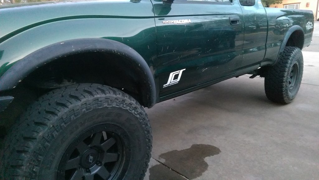

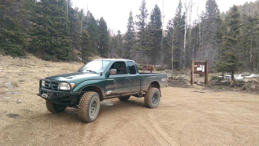

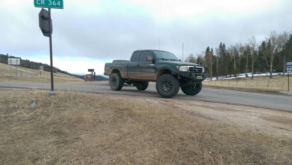

    I like it a lot! Good rake settled down to about 1-2 inches over the front which I have my bumper and winch too on front but let me grab some currents forgive the dirt lol just got back from lookin for sheds!

    But ya if you're a 4 cyclinder and don't plan on bumper or winch I would go 881's and if you are plannning on going by per and winch I would go with 882's as they are a little taller but have a lower spring rate than say 883's which are a little shorter than 882's just higher spring rate!
