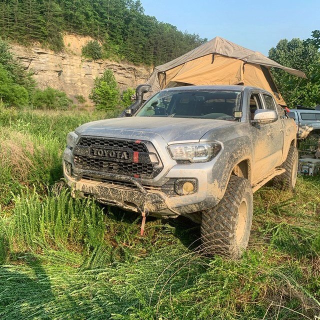

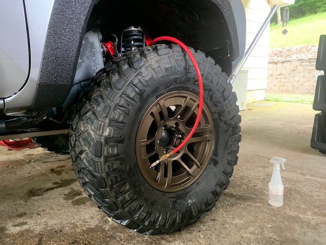

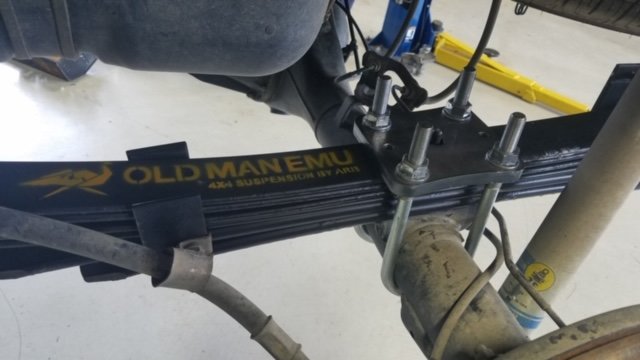

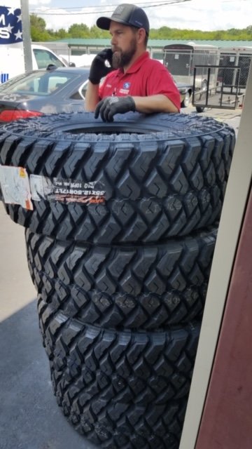

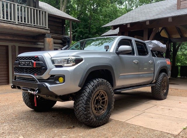

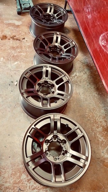

    Yep!

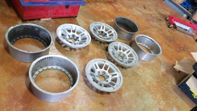

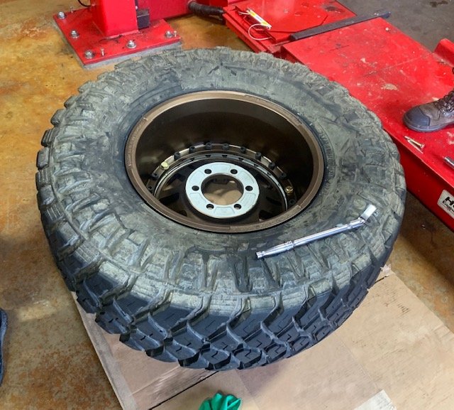

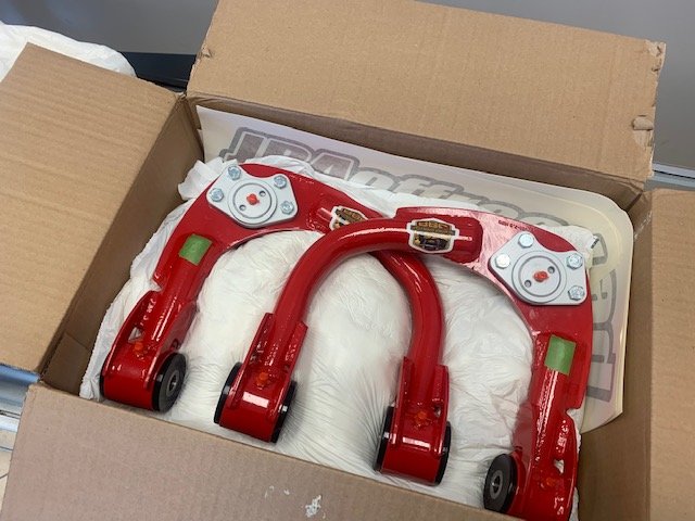

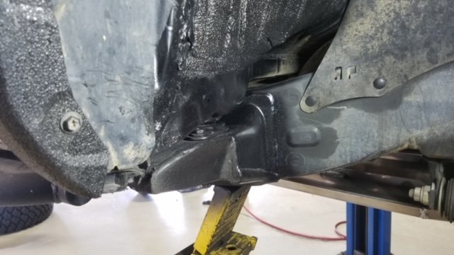

    Jumped up to 35's with a set of 35x12.5R17 Maxxis RAZR MT's wrapped on some Hutchinson beadlocks (0 offset, 1.5" G2 spacers) powder coated in triple bronze. Current setup is Bilstein 6112's (2nd gen set on top notch), JBA UCA's (+3.5* caster), OME Dakar pack (heavy), Bilstein 6100 (+2"). It required cutting of the front plastic, a small portion of the front fender flares, and a BMC. I wheeled it pretty hard right after installing, and had a bit of rubbing still at full flex, so I will do a bit more trimming. So far I love how it came out.

    They perform very well. Great traction in the nasty mud, and good on the rocks. Like any MT they have some highway noise. Aired down to 15 psi they wrapped well on the ledges.

    What are the wheels? I'm always on the lookout for something different in bronze for my BBP. Looks great man!

    Hutchinson wheels = $$$ Money well spent, but wow they are pricy.

    They are Hutchinson’s. Wheel #WO1978
