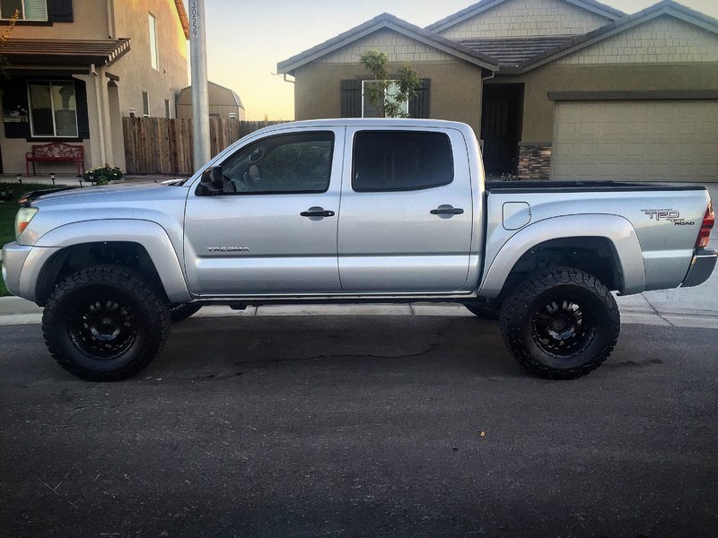

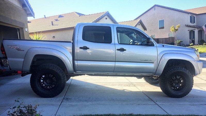

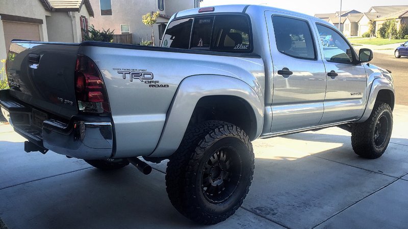

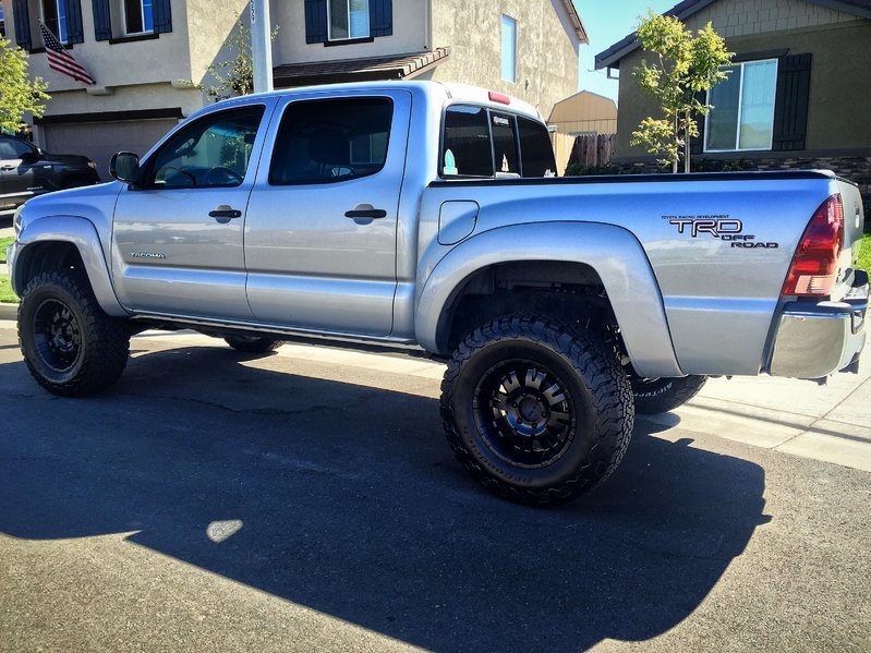

    I installed my lift last weekend. They say that imitation is the sincerest form of flattery. :D:thumbsup:
    OME 887
    Bilstien 5100
    Dakar leaf pack
    BFG KO2 285/70/17

    The 887 coil is a 3" lift but with the 285/70/17 all terrain tires I put on, it's well above a 3 inch total lift. The larger tires add extra inches to how high the cab and bed sits (if you're upsizing from stock tires).
    I'll give you exact measurements of my before and after ride hieght tomorrow.
