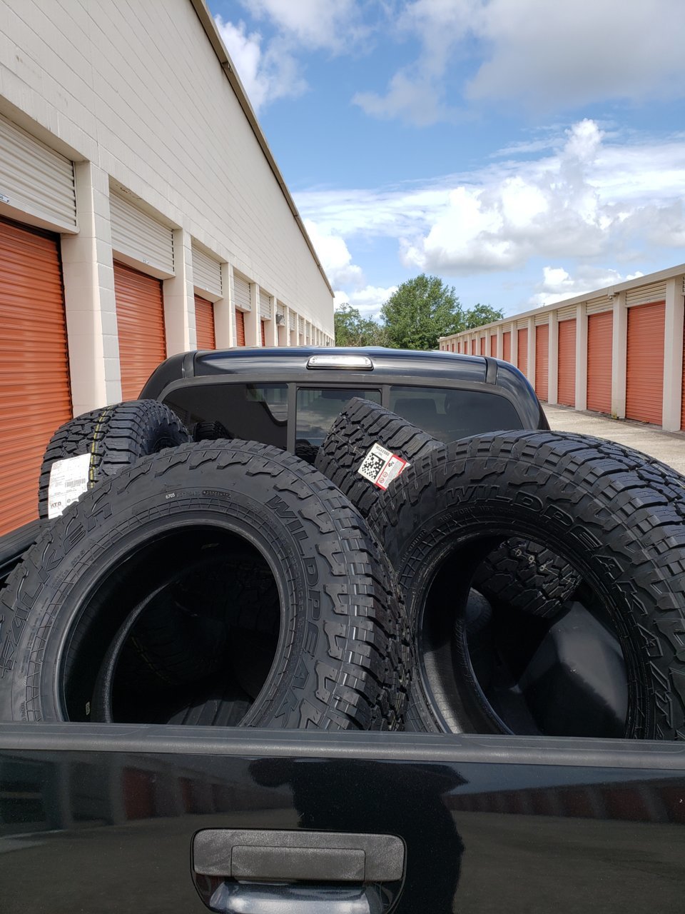

    Hello guys,
    Was at a tire shop this morning to get my five SCS Stealth 6 and Wildpeaks installed, 17x8.5 rim, 265/70R17 tire. But Mavis tire guy couldn't get the tire on the rim, said if he tried any harder the tire would rip. As I'm watching, I said can you try with the rim face up, guy said yeah but with his machines the wheels could get scratrched up and damaged. So I took my wheels and tires and left. Did you guys with SCS wheels or 17x8.5 have issues with the install? Is the tire supposed to be mounted with the wheel face up or down? Thanks in advance.

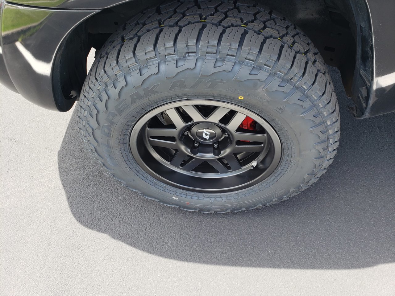

    Can’t exactly tell from the picture but looks like it could be a reverse drop. Sometimes you have to mount them with the wheel facing down and use a rubber adapter to hold the wheel in place then turn it back over to set the bead. It causes no damage to the wheel if done correctly. I get several a week on average.
