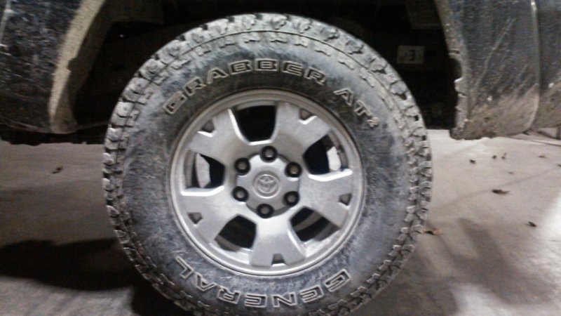

    I had a set of 235 85 R16 General Grabber AT2's before my current set of tires. I wheeled them a lot and they held up very well. They did really well in rain and snow. I'd recommend them for sure.
    I'd say the only down side to them is they tend to be a bit heavier. Although that could that the 235 85 16's are E rated too.

    Are the stock rims too narrow for the Grabbers? I currently have G
    BFGoodrich A/T, but they aren't available now in 14".
