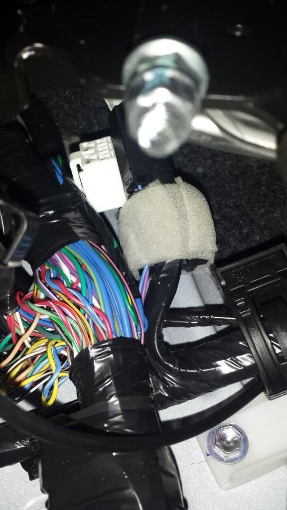

    It waaaaayyyyy back there by the firewall toward the left side.
    It had some white looking foam tape stuff on the harness beside it.

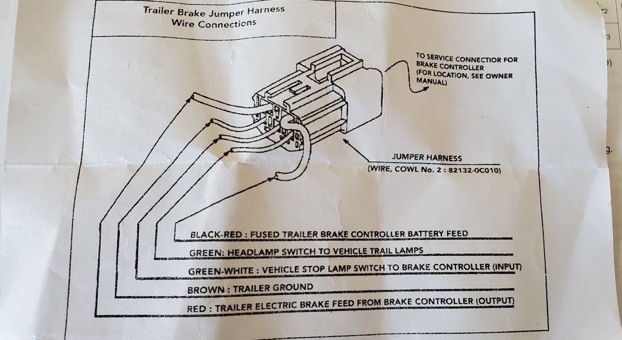

    I still can't find it but looking through some of the stuff that I got when I purchased the truck, I came across20230111_120127.jpg 2023-01-11 12.03.31.jpg

    It is a white plug.

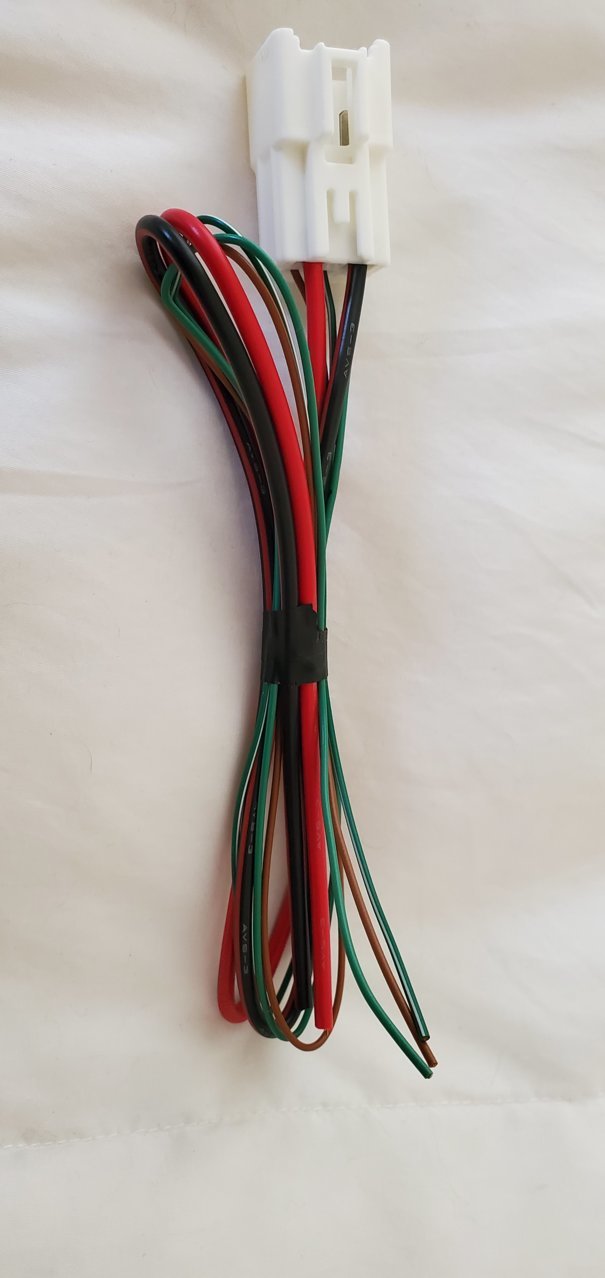

    does this imply that I need to installed this?

    Some brake controllers you will have to use that harness and splice into the new controller . It’s much easier if you order the harness with the controller. It will be plug and play.
    My truck had that harness too. It’s in the trash:thumbsup:

    This is the exact picture I used to find mine. Look for the foam tape. It will be around that area.

    I found it! Thanks so much...It was WAY back there and in the middle of the wires...again thanks so much. The picture really helped
