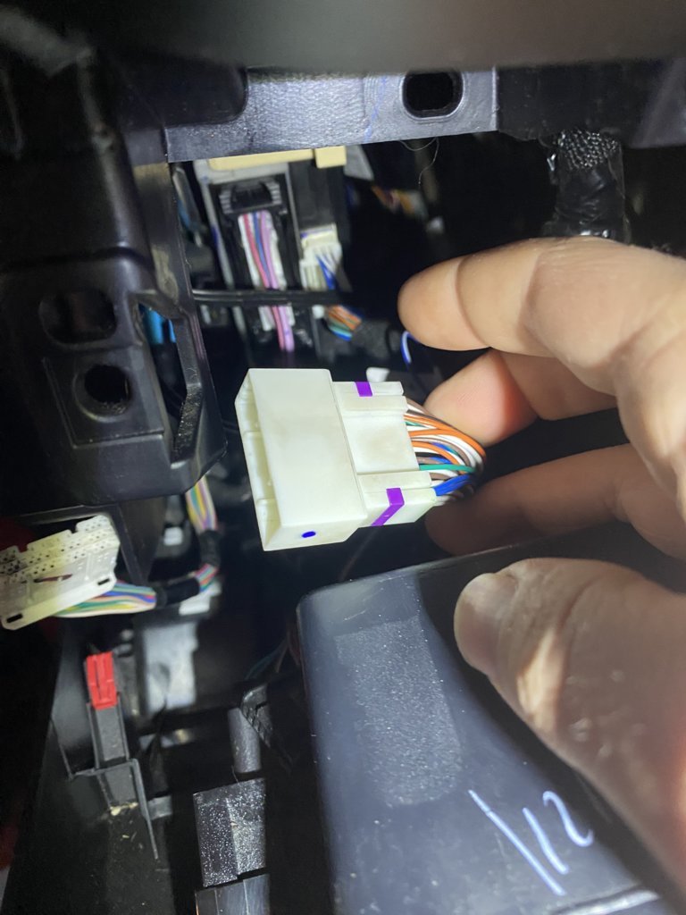

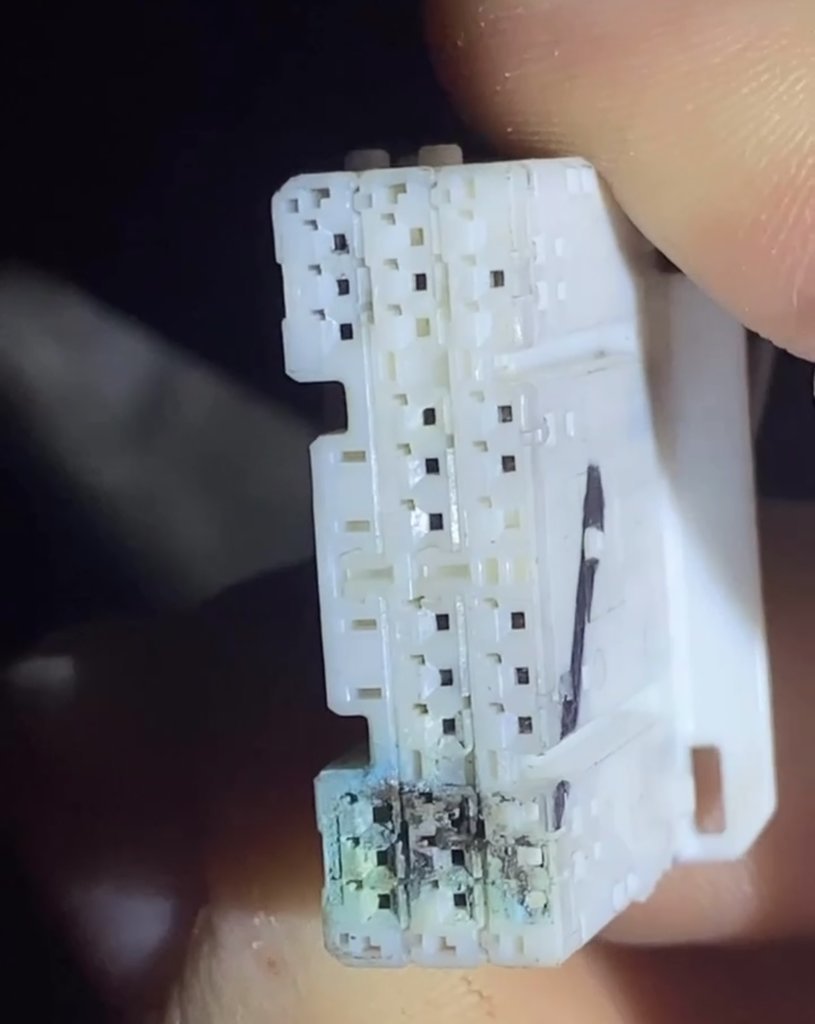

    Hi all, I’m new here so sorry if this is the wrong forum for this, I’m trying to re-pin this connector, only problem is, I can’t find what size pins to get. The plan is to de-pin, clean the connectors, then re-pin and replace the bad ones. I’m kind of a noob at this kind of stuff so any insight or advice would be appreciated. Thanks8825EDDB-993E-4B13-90C6-F8F190970EA7.jpg

    I see “1903614” on the connector, here is a picture of what it connects toD32D89EA-11EF-47E7-995C-C3F6B03B5798.jpg 232FE9C0-4BB8-4943-B720-88A230B5D4A4.jpg

    It’s located on the bottom left of the driver side where the oem switches are, im not exactly sure what it’s for, but i believe this is why my DRL’s and my power windows to stop working.

    Yes, 2018 SR5, I’ve googled all day trying to find an idea or even a replacement. But its right next to the steering wheel on the left, where the little panel with the little coin storage can be taken off with a 10mm.

    I'd say go back to vehicle and trace the cable. It seems to be a remote start connector tied to M6. (main Body ECU)

    Looks like N2 Designs

    I just wanted to updated this post, I fixed the problem, after many forum reading between here and reddit, I found out that the male connector was not OEM, it was for my viper starter and theft prevention. Could not care less that this corroded since it has a forever warranty, I disconnected the female cleaned it, took out the broken pins and plugged it back into the oem (I apologize if I butcher this horribly) the main connector “motherboard” (I called it) the male is still a loss but everything oem to the truck began working again, DRL’s and all windows. Going to get the starter/theft system looked at for free and I still have a good fully functioning truck, thanks to everyone who gave some input and tried to help!
