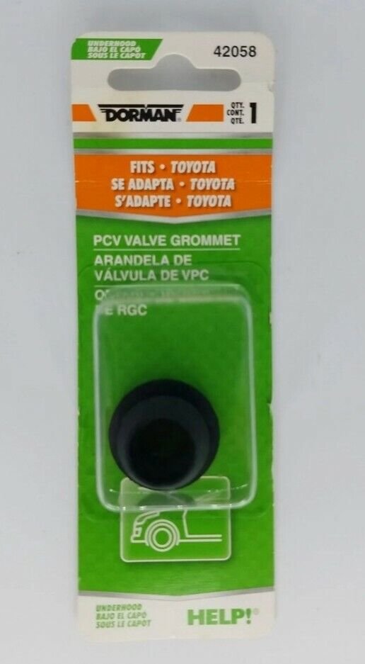

  18. Aug 31, 2023 at 6:22 PM
    #18
    O'Silver_Taco
    O'Silver_Taco Well-Known Member
    Aug 26, 2021
    #375390
    4,155
    MD
    98 Dlx Sr5 ext AT Rwd
    3rz to 2Rz bebuilt block and new heads
    These right here I replace once a year....and never go past two....
    they tend to crumble and develop a crack vacuum leak right at head surface or below you never see...
    over time they dry out and turn rock hard....
    I use curve needle nose and hemo's to get the old one out....
    Dorman PCV Valve Grommet 42058 (autozone.com)
