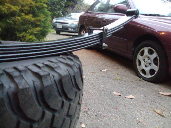

    Something like this ?? I built these today...

    Well they look solid enough
    But yeah, I was going to say that I do not have the TSB upgrade either.
    Is there anything I should ask for buildwise when I talk to the shop 4WD?
    I am looking for flex and the ability to take a canopy six months a year without considerable sag
