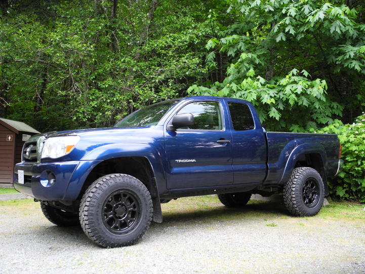

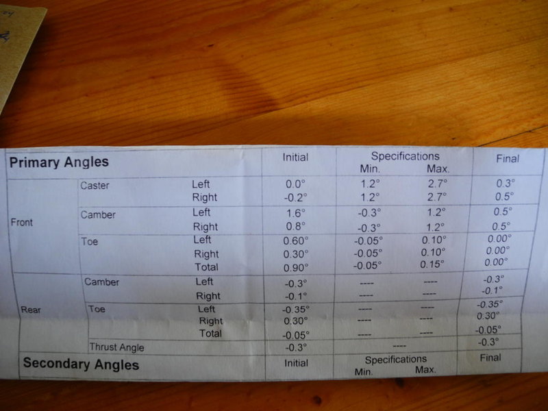

  10. May 15, 2012 at 4:55 PM
    #90
    06tacomakev
    06tacomakev Well-Known Member
    Dec 29, 2011
    #69602
    191
    Kev
    Victoria BC
    2003 tacoma 4x4 dblcb
    so after some driving, the front settled at 24.25 (hub to fender)
    the rear at 25.25
    Tough to say what the exact amount of lift was because I only ever measured with the spacer lift in. Never measured when it was stock.
    But with the numbers I have I think it is safe to say a solid three inches in the front with OME 885x on 5100
    Very Happy with the way the rear turned out. I can actually throw weight in the bed now lol
    here is a pic and the alignment numbers. Tires are 265/75r16
    And yes the caster numbers blow. Couldn't get the light racing. Basically months away.
    So I will see how it goes. Right now there is no wander, but I will be watching my front end for tire wear and such
  11. May 15, 2012 at 4:57 PM
    #91
    OZ-T
    OZ-T I hate my neighbour
    Dec 15, 2009
    #27584
    50,587
    Peter North
    British Columbia
    What do your CV angles look like ?
    24 1/2" is alot for a 4x4 , like 3 1/2" - 4" over stock
    Isn't your caster like way low , under minimum specs ?
  12. May 15, 2012 at 5:02 PM
    #92
    06tacomakev
    Dec 29, 2011
    #69602
    191
    Kev
    Victoria BC
    The caster is way low. Like I said I will drive it and see how it plays out. Control arms just weren't available.
