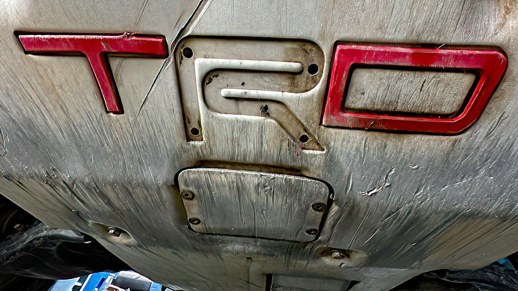

    Another option which i chose was just to leave it raw. Why maintain a coating on something that will see salt spray every winter if you dont need to?
