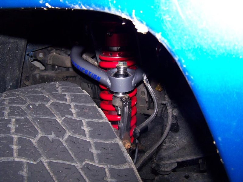

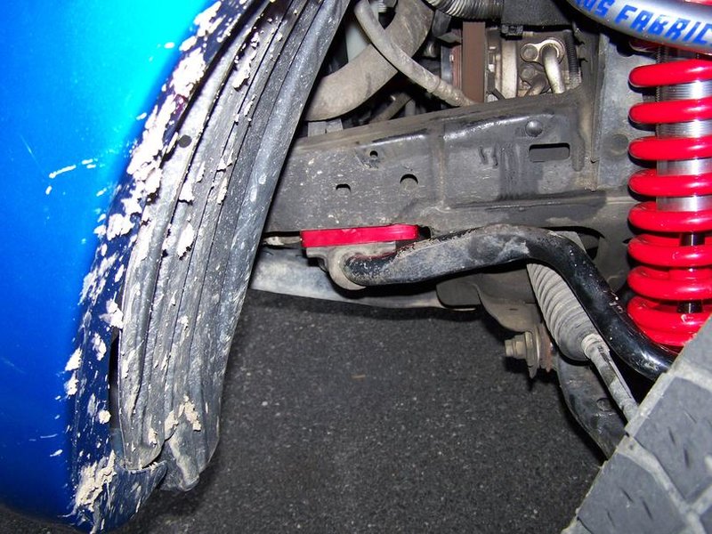

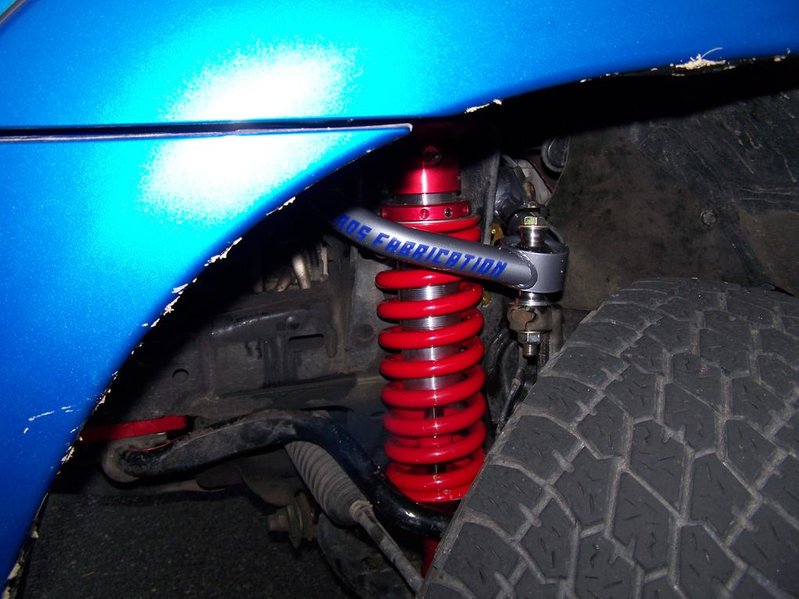

    finished my front lift on sat on the worst day of rain i have seen in a while since i dont have a garage i was out side all day in the rain only
    and when you do change out to the total choas ucas make sure you get different grease fittings or a tap to clean the treads since they powder coat the internal threads i think its 1/8 npt threads
    btw i installed sway away 2.5 coils and total chaos uca i swithced from the stock trd sport struts and 3 in spacer lift so if any body is looking for any stock suspension or 3" spacer lift let me know
    i am going to be doing the rear shocks sometime this week i already have 2" aal ill be adding race runner shocks and 1 " blocks
    i still need to figure out how high i need to adjust the shocks( i already did full turns) before i add the 33x12.50x17 mickey thompson baja claws and do the alignment
