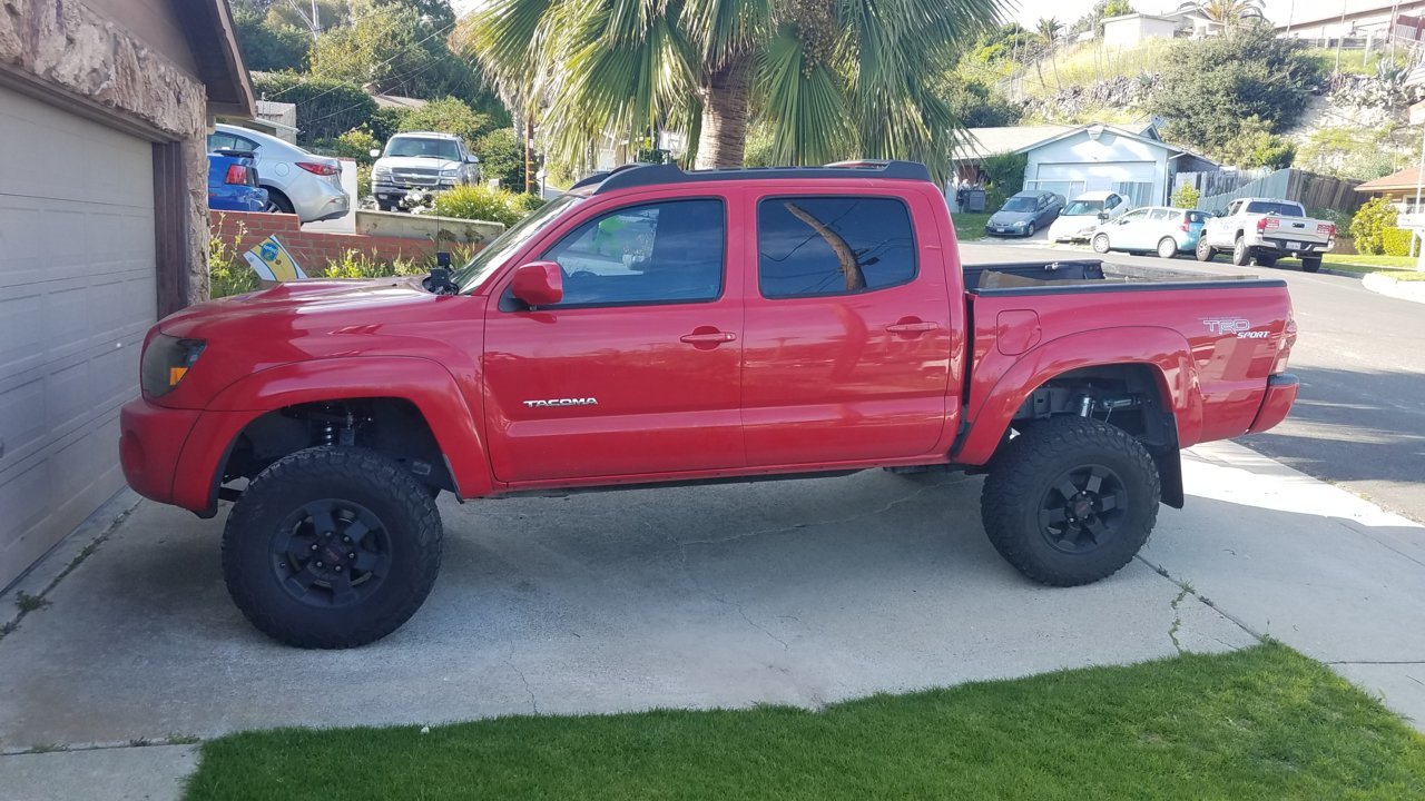

    well its been a while coming but I finally got down and did it. so far I love it and it rides nice. My goal is to eventually add Dirk King LCA and strap it. Id like to have Dirt king do the rear with bed cage and leafs. any ways here's what I did,
    Front end:
    New rack and pinion with moog tie rod ends, What a PITA but this website helped a lot
    Max trac 4" spindles with extended brake lines
    new hub's
    Dirt king boxed UCA with heim's stock length
    Bilstein 6112 on first clip
    Temp Rear until I see what economy does:
    2" block
    5160 in the rear

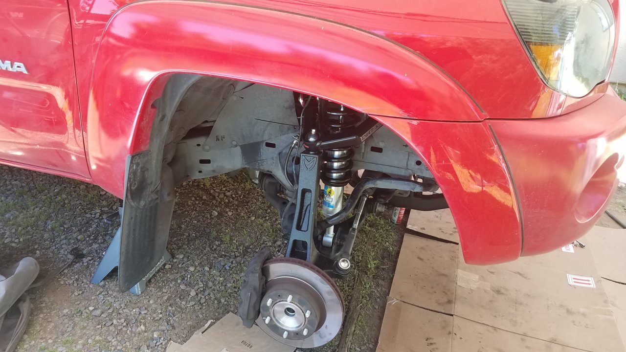

    Looks good op but did you use 4wd hubs? My old prerunner hubs didn’t have a hole in the middle. They had a cap pressed in them.

    they are 2wd hubs, notice there are no spline grooves, just no cap. They are not Toyota OEM, I Gambled and got some aftermarket ones off Amazon.
