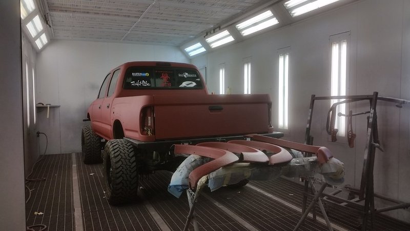

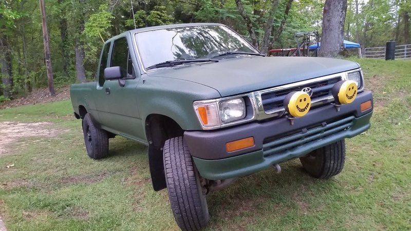

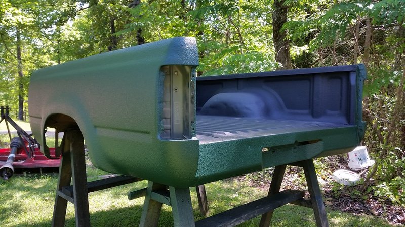

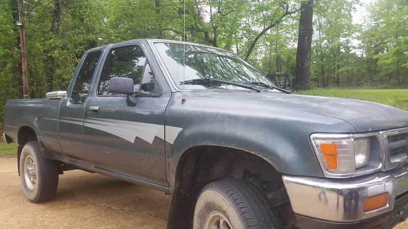

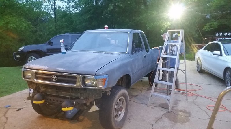

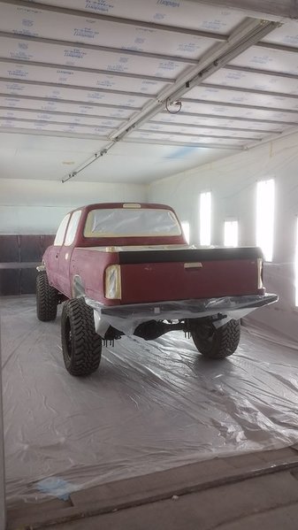

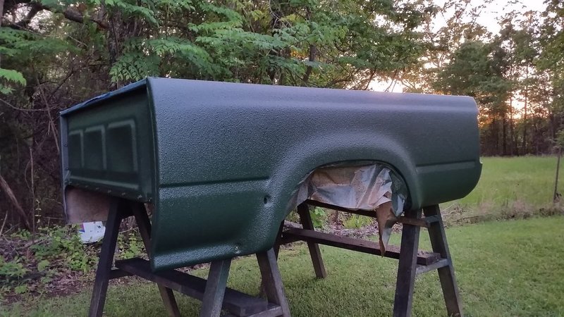

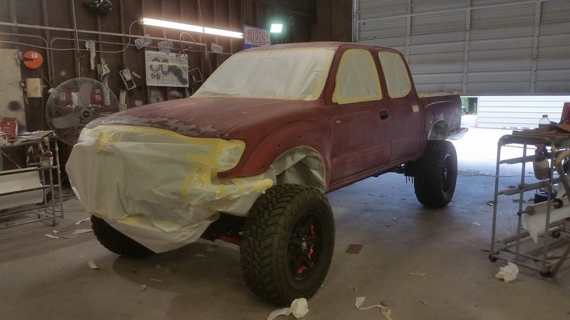

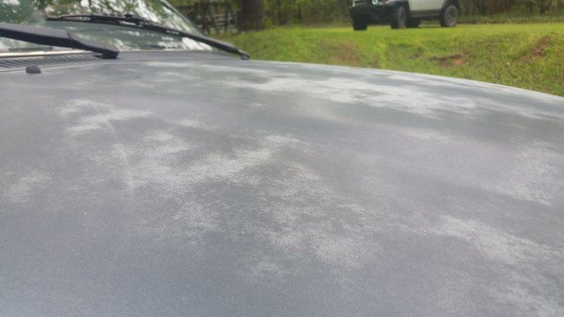

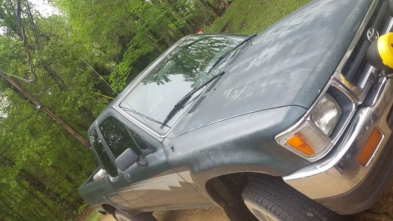

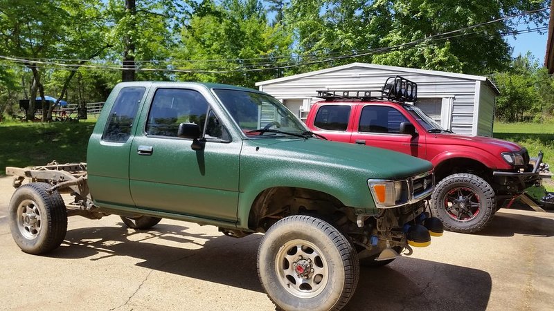

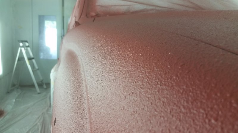

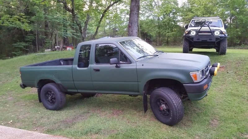

    IMG_20150504_171713.jpg Im starting a thread for my Monstaliner install ill be posting as i go along so feel free to subscribe! I have a 2002 Toyota Tacoma Double cab limited model in Impulse Red. I will be spraying the Monstaliner on May 9th in Blood Bath red. The reason im spraying my ENTIRE truck is because i have a lot of rock chips on the hood and tailgate along with what looks like hail damage on hood and roof also have scratches all over the vehicle from trail riding. I've already monstalined my dad's '92 Toyota pickup in Jungle Love green ill post some pics of this below! (His was a test vehicle) :thumbsup: I ordered the 2 gallon tintable kit along with 2x 8 ounce color of Blood Bath ill be thinning the liner with MEK and spraying through a Shutz Gun ill be doing the spraying and my friends body shops paint booth.IMG_20150504_171713.jpg 20150417_162017.jpg 20150417_162023.jpg 20150417_162031.jpg 20150417_192816.jpg 20150420_190738.jpg 20150421_143305.jpg 20150421_143407.jpg 20150422_191253.jpg20150422_191317.jpg

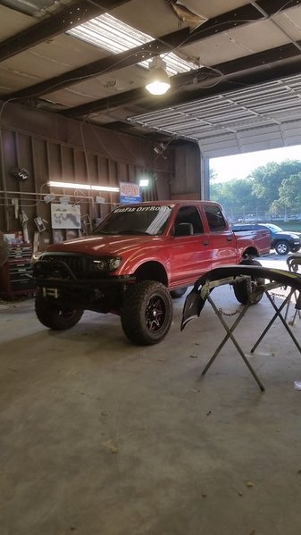

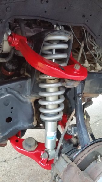

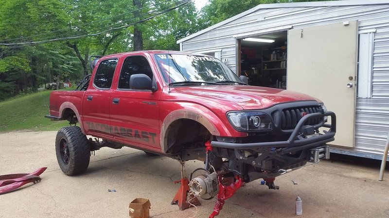

    20150506_152248.jpg 20150506_174638.jpg 20150507_154310.jpg Yesterday I started removing coils to add toyteclifts.com 3/4" strut spacer to level up front more and started painting the control arms red and painting frame. Also removed roof rack, fender flares, decals and badgeing getting ready for the monstaliner install Saturday!

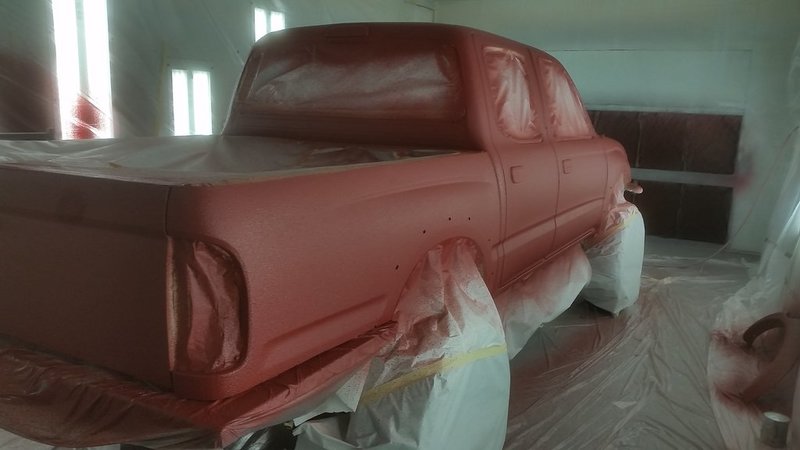

    20150509_072612.jpg 20150509_134418.jpg 20150509_141245.jpg 20150509_144232.jpg 20150509_173833.jpg 20150509_173903.jpg 20150509_193555.jpg 20150510_085720.jpg 20150510_085745.jpg Finished the monstaliner install!!

    And since it is back, why did your dads truck have the bed removed for the application, but not yours?
