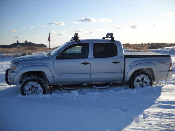

    QUESTION CAN I ADD A 1/4 OR 1/2 " SPACER UP FRONT ON DRIVERS SIDE TO FIX THE LEAN ID LIKE TO DO A 1/2 OR DRIVERS SIDE AND 1/4 ON PASS SIDE IS THIS POSSIBLE????
    AND IF SO TO I HAVE TO COMPRESS THE SPRINGS AGAIN TO INSTALL THE SPACERS????
    HERE ARE SOME PICS
    this was 5100's at 2.5 nothing in rear
    front at 2.5 and the 2" aal in rear
    no rear aal in this pic just fun in the snow

    Looks great! I have seen elsewhere on TW someone added a 1/4" spacer to the drivers side. What is your measured difference?

    How pronounced is the driver side lean? Is this a common problem with the 5100s? Truck looks great btw.

    It leans on the driver side from the weight of the gas tank and driver. Toytec has a 1/4" spacer that sits on top of the coilover to fix the lean.

    I don't notice it on my stock suspension, a lot of people notice it after they install a lift. BrutalGuy your truck looks great, I'm gonna do a similar setup with Eibach coils and 5100s set at .85 with 1/4" spacer and 1.5" aal. How does yours ride, is it noticably firmer?

    and my measurent difference is driver front 1/2 lower than pass. side

    with the half inch spacer you need longer studs, so you'd have to take apart the coilover and replace the top plate studs and put together and put back on
    edit: maybe not the 1/2 but the 3/4 inch, need the longer studs.

    Yes you can add a 1/2 inch spacer on the driver side and a 1/4 inch spacer on the passenger side. You will need to add longer studs to accomodate the 1/2 inch spacer though, no big deal.

    Ok i just want to use a toyo tec 1/4" spacer...just on the drivers side
    if i did that would i have to get longer studs & would the coils need to be compressed ???

    ya the coilovers would need the top plate removed, so the springs would need to be compressed.
    for the 1/4" im pretty sure you dont need longer studs

    The 1/4" or 1/2" go on top of your coilover, so you don't need to compress to put those on just compress for longer studs.

    No and no, but you would have to use a different nut because the OEM nuts are super thick.
