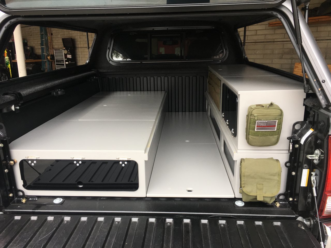

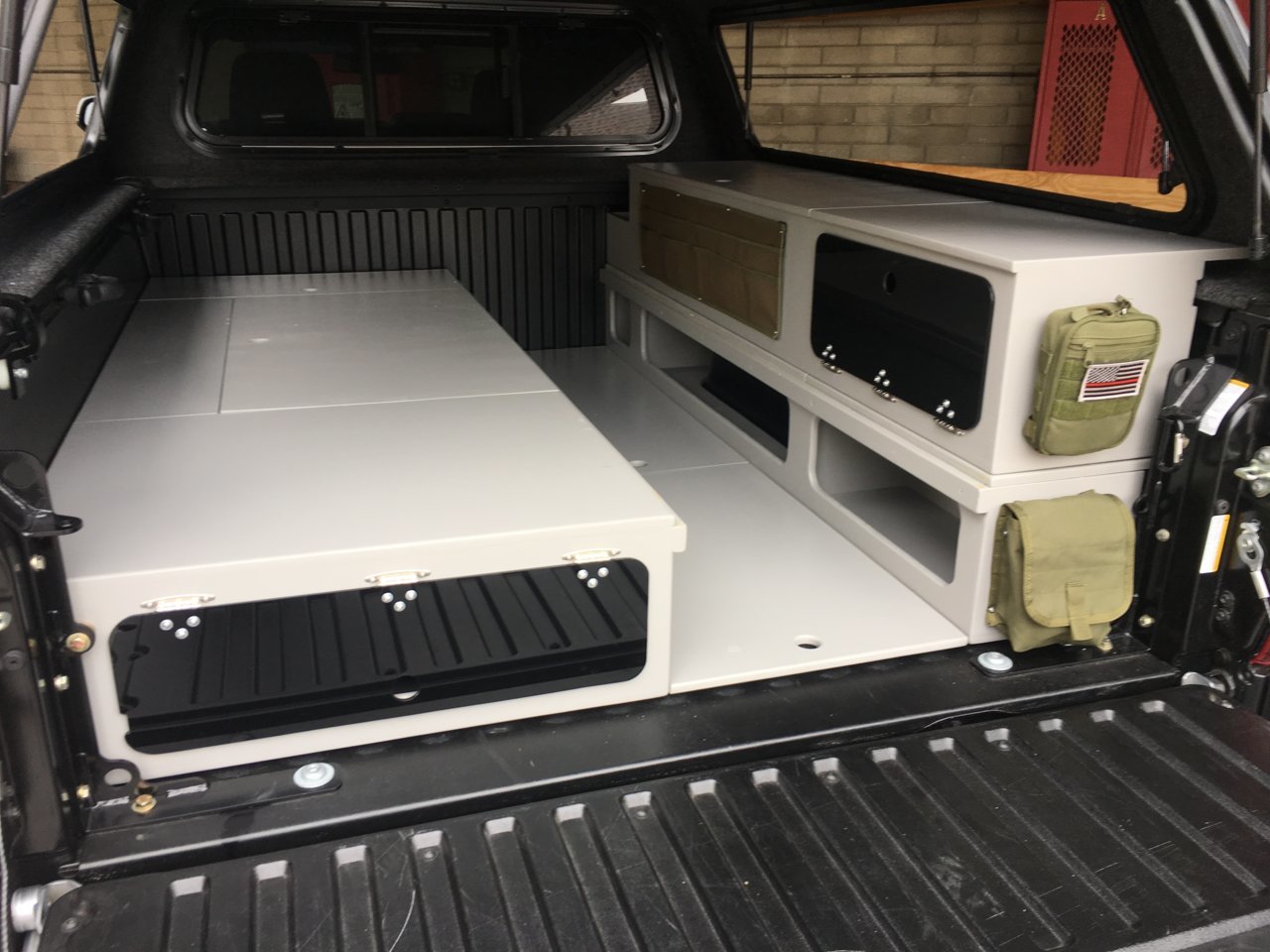

    @GOTSAND?18 the whole sleeping platform is removable... it is secured with some bolts with wingnuts for easy removal. And it breaks down into 3 sections. I can have it completely out in about 10 minutes.

    @UCantHeng i used Home Depot exterior latex paint/primer.... “grant grey” is the color in a semi gloss finish. I used a roller and brush to paint it. I wanted something easy to repaint when it gets scratched later on. The platform is not water tight... so something like this probably wouldn’t do well with out a shell unless you use marine grade varnish and seal all the cabinets to be weather tight.

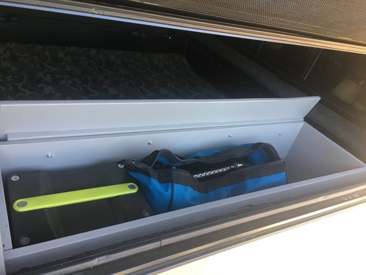

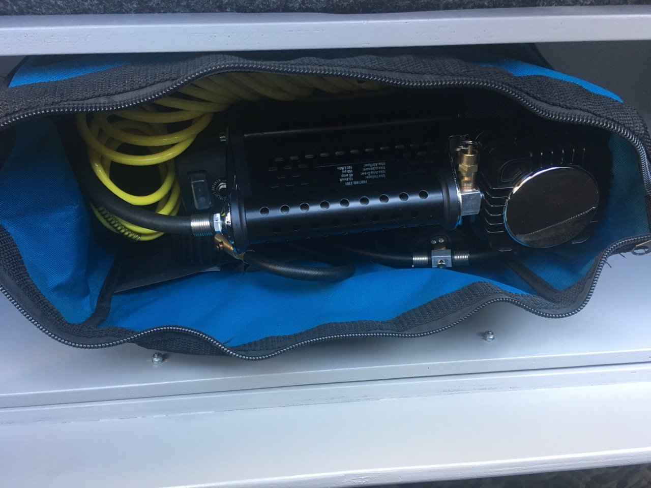

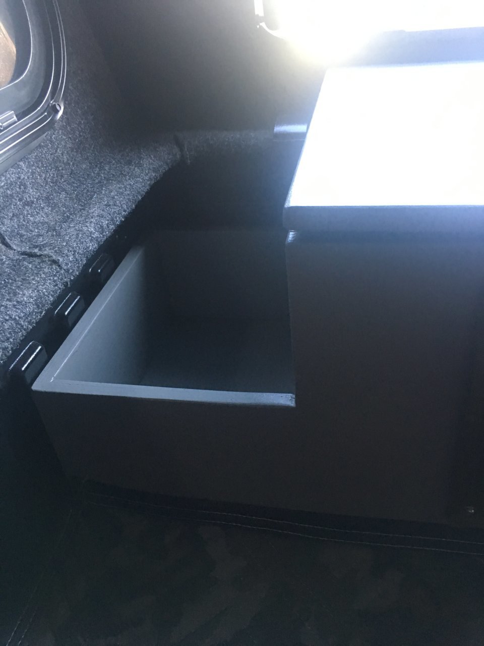

  18. Oct 18, 2018 at 6:00 PM
    #38
    tonygmz13
    tonygmz13 [OP] Member
    Feb 6, 2018
    #243659
    15
    Long Beach, Ca.
    2017 Tacoma TRD offroad

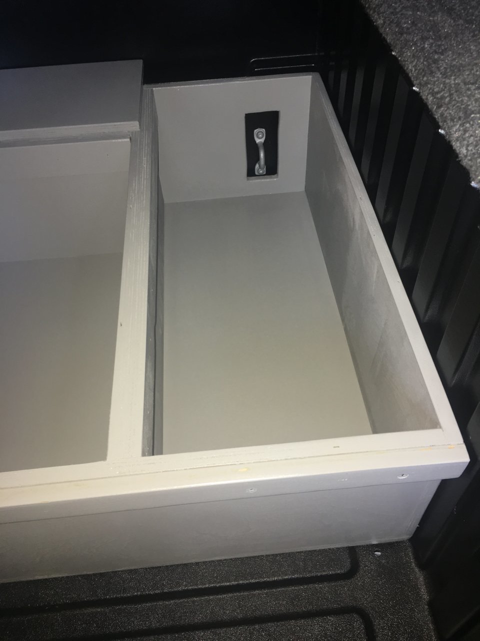

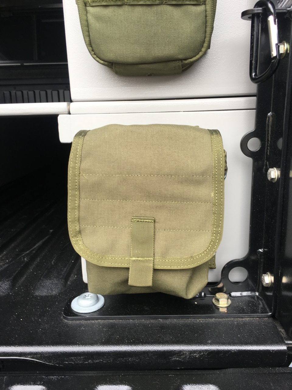

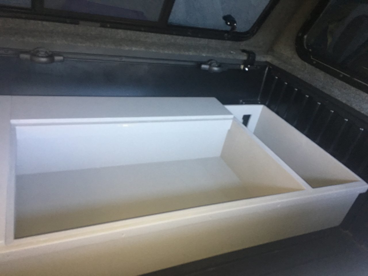

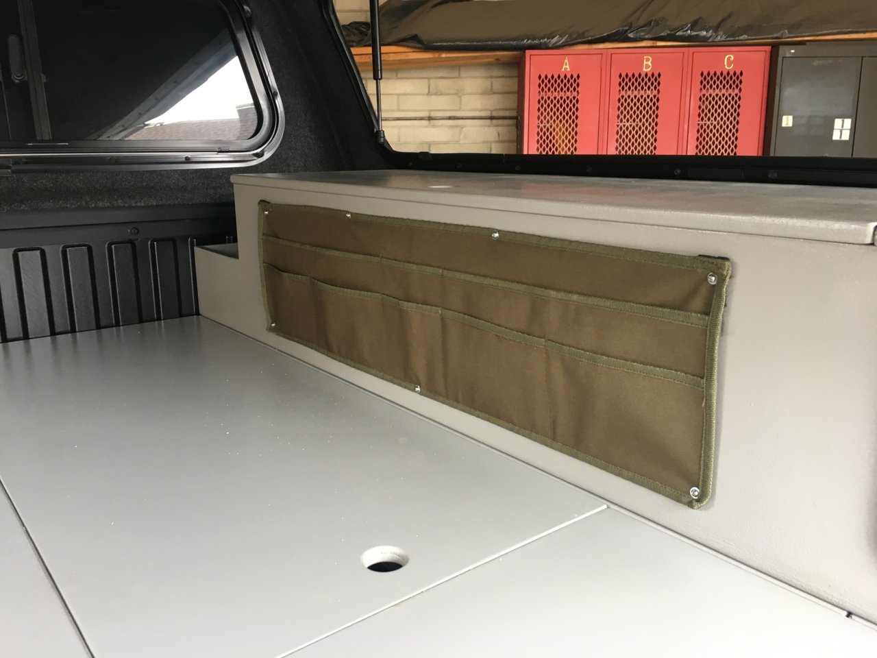

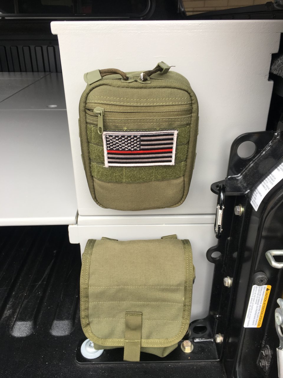

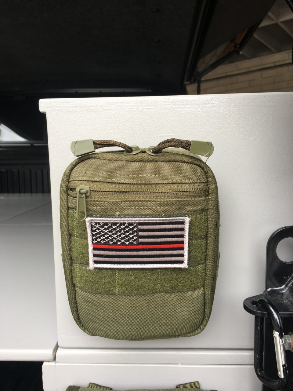

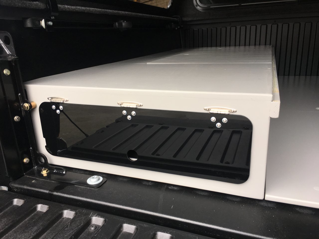

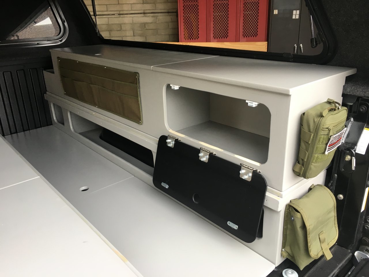

    Here are some pictures of the inside of the cabinets. I’m working on where everything is gonna get stored.

    what is holding all those box covers in place? Also when the sleeping platform inserts are in their lowest position. Very nice work, i built drawers/sleeping platform for my 1st gen. i really like your approach.
