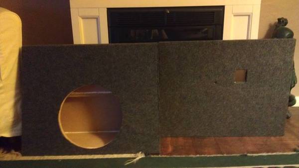

    So I finally finished putting together my box after designing and cutting the pieces back in February. I am going to be running a Sundown Audio SD-2 12 and the manufacturers recommended volume is 1ft^3 but my box is about .75ft^3. The question is should I add some polyfil to it and if so how much should I add?

    Just get a little $5 and put it in there.

    You should be fine with one of the pillow sized bags should be around 5-10 dollars.

    I usually suggest about one pound per cubic foot. It's better to buy the loose poly-fill, generally referred to as pillow stuffing.
    You're looking too fill the box loosely. Don't pack too much in or you will defeat the purpose.
