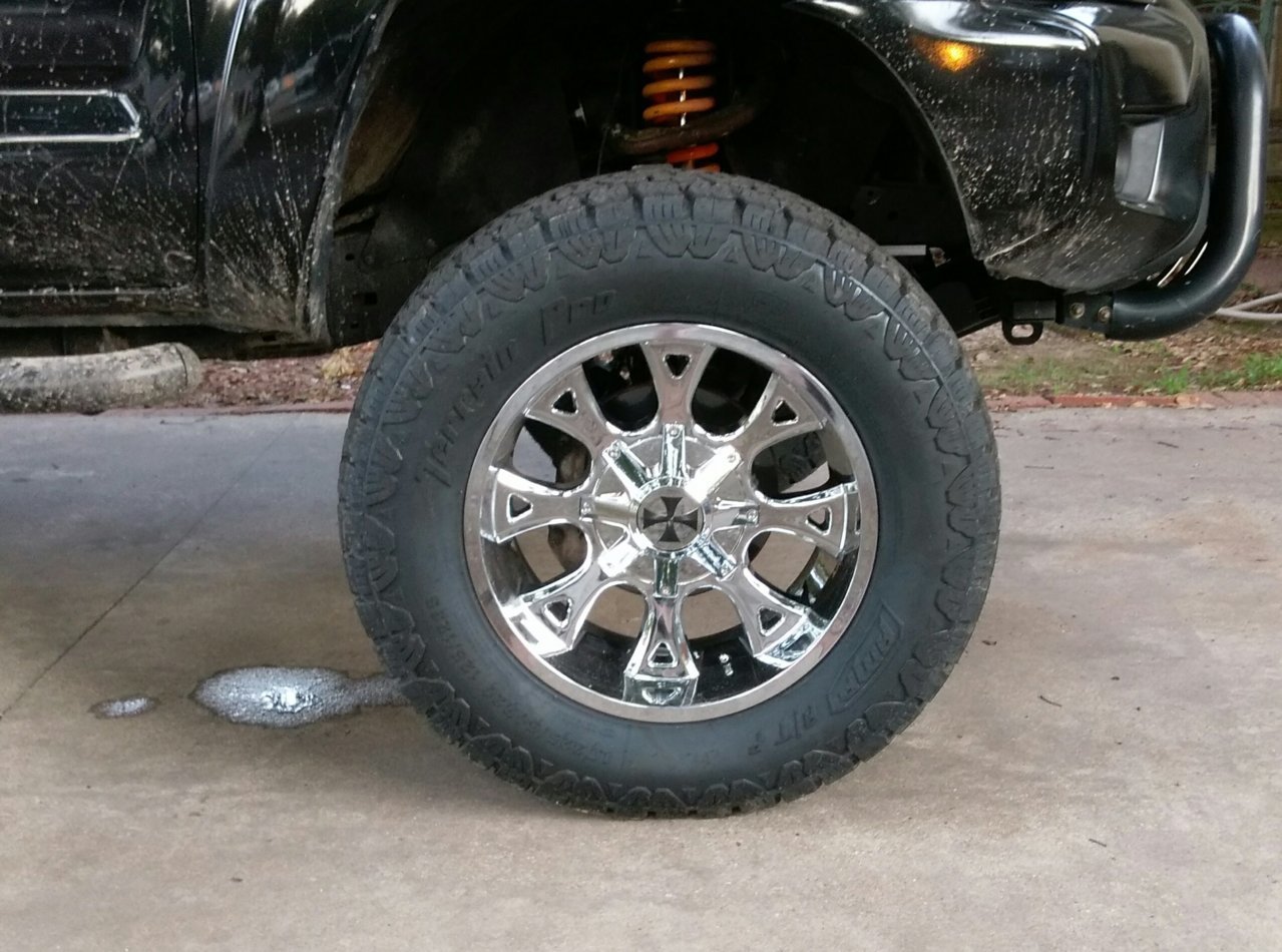

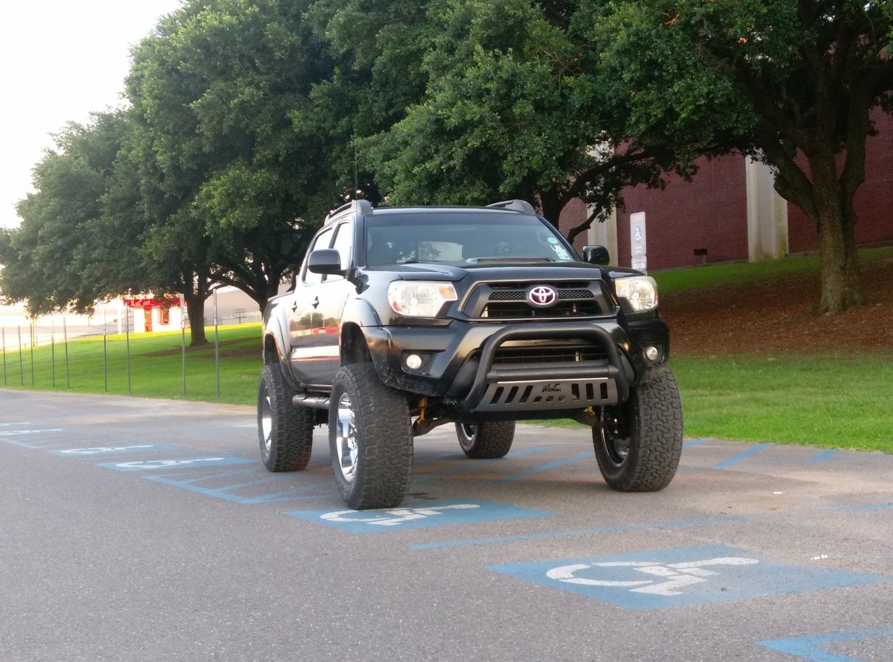

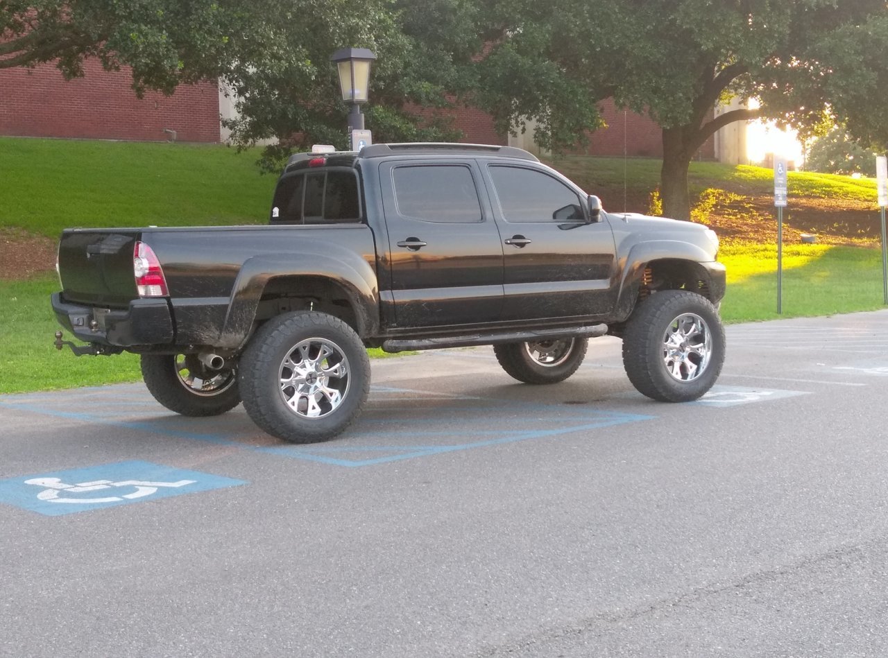

    Howdy,
    Just finished latest additions, I know she's dirty but you think?
    3" Ironman coils
    4" Maxtrac Spindles
    Cali Anarchy 20"x10" wheels (4.75 backspace and -19 offset)
    325/60/R20 (35.5x12.8) Amp Offroad All Terrain tires
    3" Deaver's and 3" blocks in the back (may swap them with 5" blocks, undecided)
    Dobinson's shocks and struts
    27.5 inches from center of hub to bottom of fender, no rubbing.IMAG7661_1.jpg IMAG7666.jpg IMAG7685_1.jpg IMAG7656.jpg

    Not normally a fan of 20s but yours looks great. Got enough rubber on there to not look like a mall crawler. :thumbsup:
  5. Jun 8, 2018 at 8:47 PM
    jboudreaux1965
    jboudreaux1965 [OP] Ragin Cajun Fan
    Jun 2, 2014
    #131162
    3,826
    Joseph
    Hub City
    2023 TRD Sport
    Thanks guys!
    I want to note, I was skeptical about the Amp Offroad tires. I was dead set on K02's, even ordered them. Years ago I had BFG A/T on my jeep, they were great! But BFG must have made some changes with the K02's, my brother in law got new ones a couple months ago, my neighbor got new ones a couple weeks ago and both complained that the new ones were bad in the rain. So I cancled my order. After talking with several guys locally who have the Amp's on Tacomas and 4Runners, they had only good things to say. Since they were about the same price, I decided to try them. They have been on the truck for only a day, so no offroad info yet, but of ALL the tires I have ever run, the road noise is way less... so far. We will see after they are broken in, lol!
    About the rear, should I lift it more?

    Let it settle before you go lifting any more. With mine I was a 3/4 lower in the rear untill the front settled and now I'm perfectly level

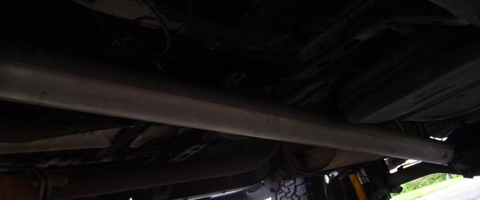

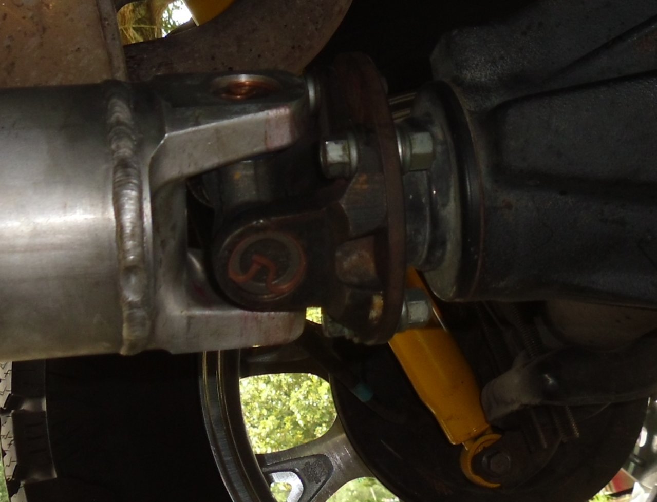

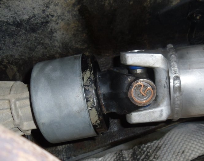

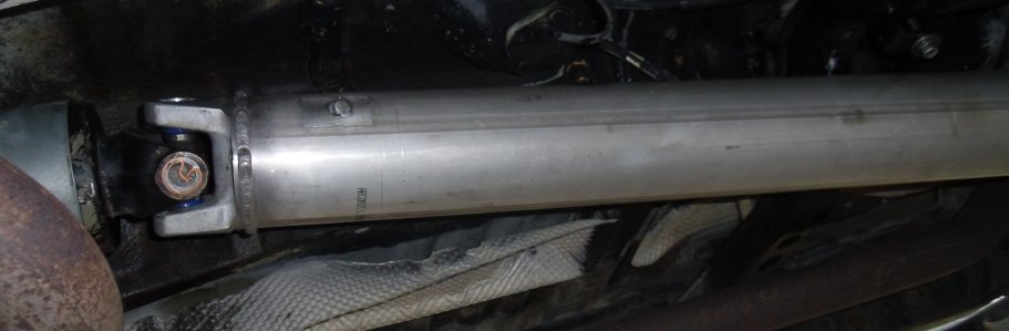

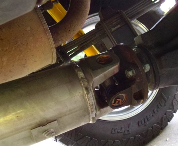

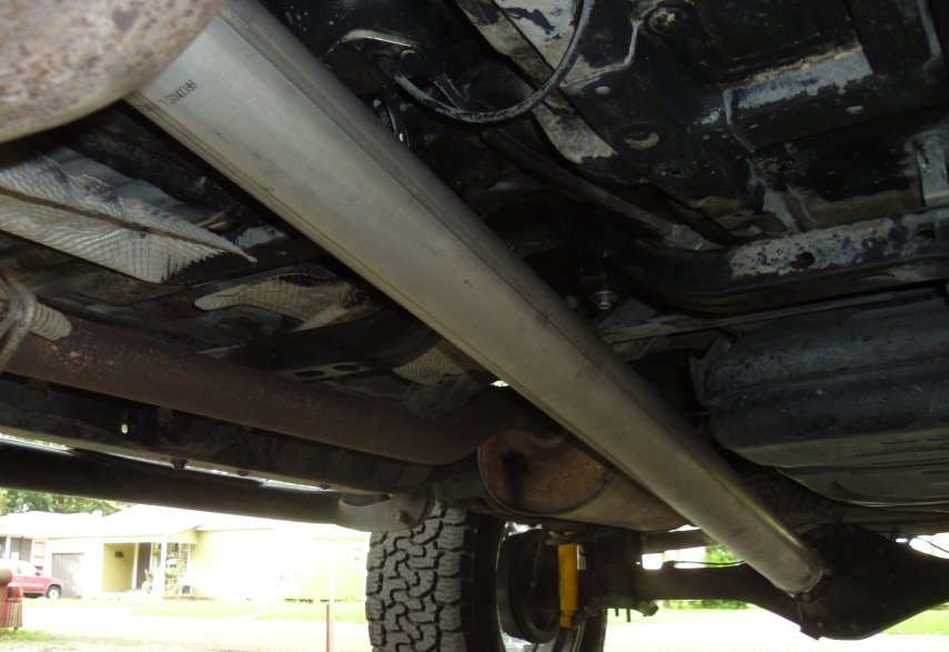

    New driveshaft should be ready tomorro! Hopefully goodbye to vibration, fingers crossed :)
    Naveronski likes this.
  16. Jun 30, 2018 at 4:40 PM
    #16
    jboudreaux1965
    Jun 2, 2014
    #131162
    3,826
    Joseph
    Hub City
    2023 TRD Sport
    Installed new Alum. one piece driveshaft today, YES, on a Prerunner! ZERO, I mean ZERO vibrations any more! Even from a dead stop, on full take off, nothing! The shop said they had made several before for these trucks with good results. When I was picking mine up, someone else was ordering one. It has only installed for one day but with GoPro running under the truck, I ran it through the paces. Highway+ speed for 5 miles, normal driving, speed bumps and jumped it off the ground at a RR crossing. The yoke only moves slightly in and out, just about like it did with 2 piece driveshaft. We will see... so far, so good! Will keep you guys updated!
