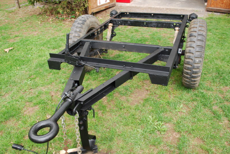

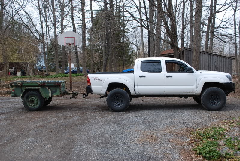

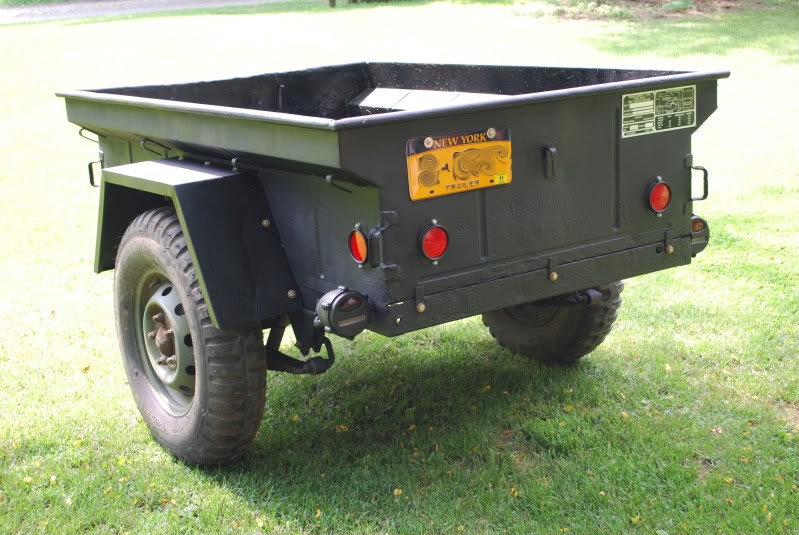

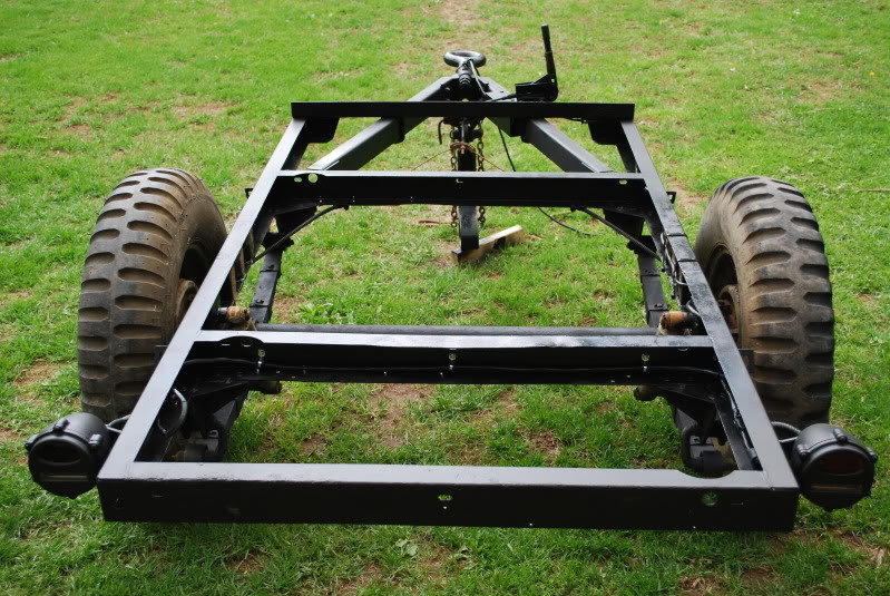

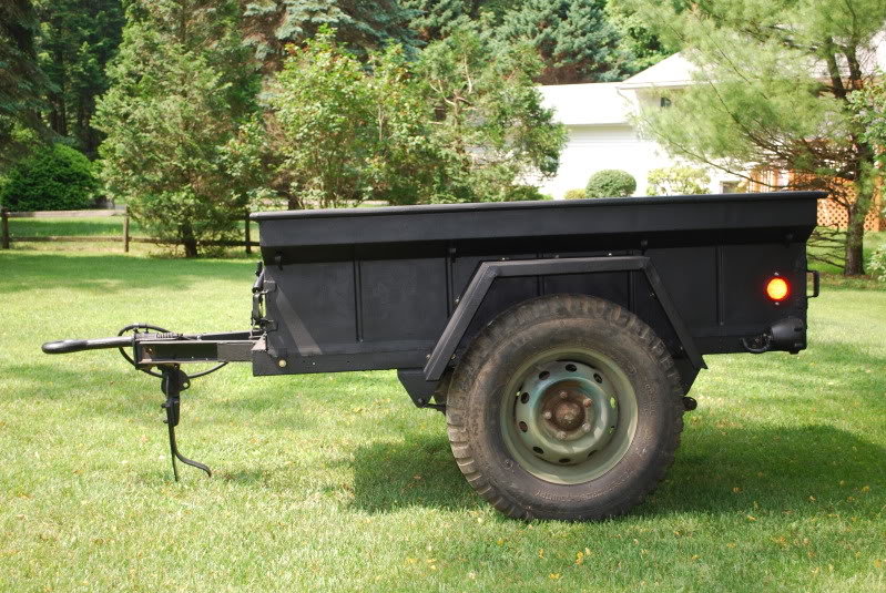

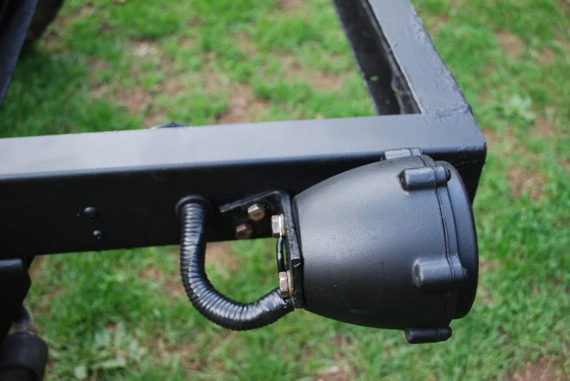

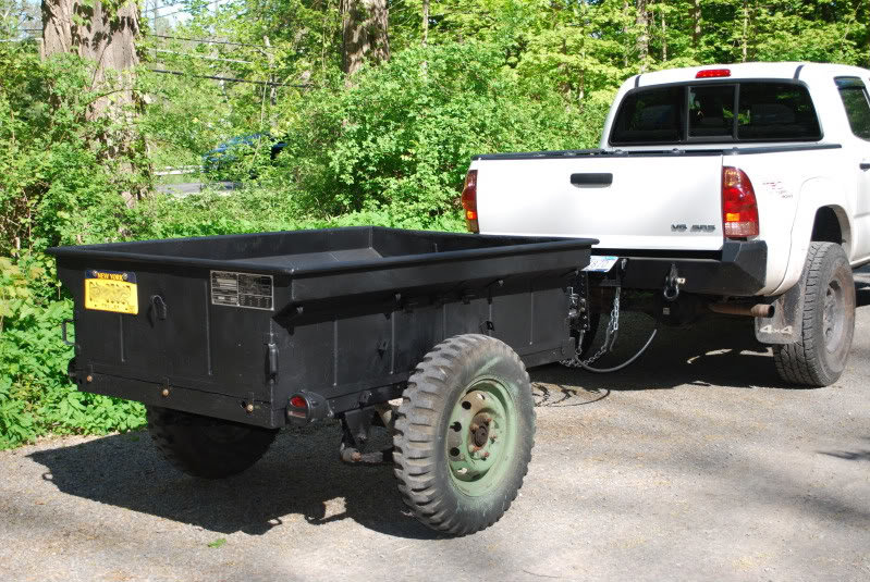

    I bought a solid 1967 M416 military trailer this winter to tow behind my Tacoma. I pulled the tub off the frame and sandblasted everything. Then everything got a coating of POR15 and then I sprayed everything with truck bed coating. Also rewired lights and switched them over to 12v. Im pretty happy with the finished product. Only thing I might still do is the spring over. :D
    The day I got it home
    Few pics during build
    Just missing fenders
    Done

    $500 for the trailer + the 100 miles each way to go get it. $50 for can of POR15. Not sure the cost for all the new Grade8 hardware and other odds and ends. Maybe $50-$75. I saved every receipt for everything I bought for it. (I do that with all my vehicles I build :)) I just havent calculated total cost yet. All the sandblasting was the most time consuming and shitty part of it. I would guess maybe around $700 total cost.
    Yeah. Just been lazy.
    $500 and check out this info plate for dimensions. :thumbsup:

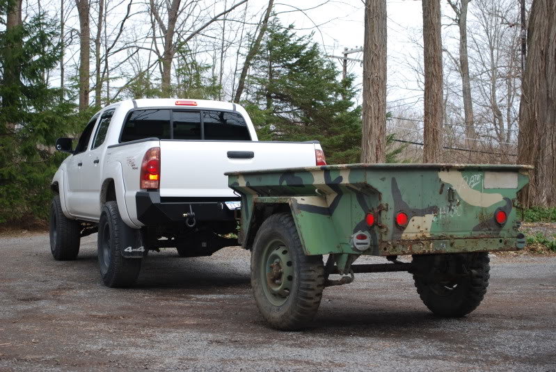

    How old are those tires? Going to upgrade those? Old trailer tires make me nervous if any weight is on them.
  11. Jun 10, 2011 at 9:50 AM
    EVILSTI
    EVILSTI [OP] Well-Known Member
    Mar 19, 2010
    #33539
    746
    Ray
    Catskill, NY
    1994 FZJ80 / 2014 Ford Raptor
    94 FZJ80 Land Cruiser Slee 6" lift kit 37" KM2s 17" procomp wheels Snorkel .......................................... SOLD: 06 TRD OFF ROAD OME Suspension lift kit with: Front OME 90000 shocks, 886 coils, top plate spacers, complete OME Dakar leaf spring packs, Front Diff drop kit, Rear N182 shocks, OME trim spacer, OME carrier bearing drop bushings, American Racing Chambers 16X8, Yokohama Geolandar A/T-S 285/75-16s (Winter tires), BFG MT KM2's 285/75-16, satoshi grille mod, TRD CAI, AP front bumper, AP skid plate, Cobra 75 WX ST CB, 2' Firestik antenna, Pioneer Avic-U310BT, Beefed Sliders, LR UCA's, Tinted Headlights, AP Rear bumper, DTLTH, Smittybilt XRC10 comp winch, Yellow top D35, pAP custom Transmission Skid ;-) , NFab spare tire holder, DT Pipe Bomb,
    They aren't originals. They are a little dry looking in a few spots. They will be getting peplaced also when I find a deal on a set.
