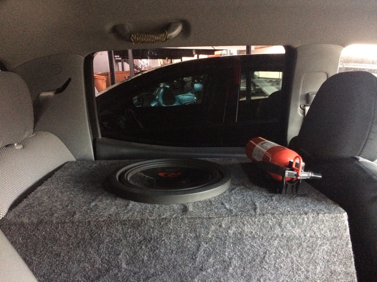

    Got mine mounted behind my driver's seat :thumbsup: (Pick is before I actually had it secured) I used reusable zip ties so its extremely well secured but i can pull it out in less than 5 seconds. When you're talking about fire, every second counts.
