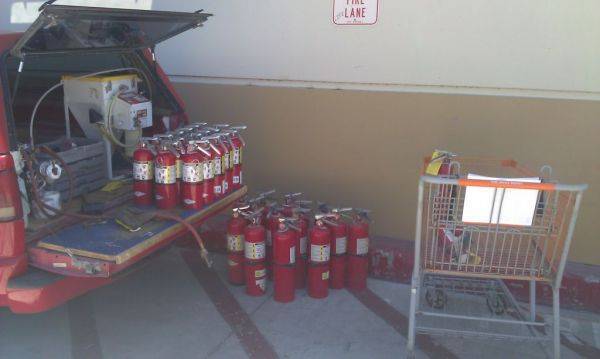

    this was 15+ 5lb abc extinguishers and 10+ 10lb abc ext at a home depot in temecula that i serviced last month. i service and sell fire extinguishers for a living so of course have numerous extinguishers in my home and of course on my truck. the problem with trying to mandate fire extinguishers on all vehicles not just for commercial use like all 18 wheelers, cement trucks, and so on, is that you would then have to regulate the service of said fire extinguishers. meaning you would have to have the fire department or chp do inspections on every vehicle once a year just like what has to be done in all business open to the public.

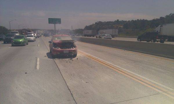

    and this was on the 91 west freeway the other day in corona right after the 57 fwy this ford focus rear ended a dodge truck in the fast lane and when i pulled up the whole engine compartment was in flames and was dropping smoldering plastic and engine parts on to the freeway, i was in my work truck, so had 20+ extinguishers on me. it took 2 full 10lb to put it out

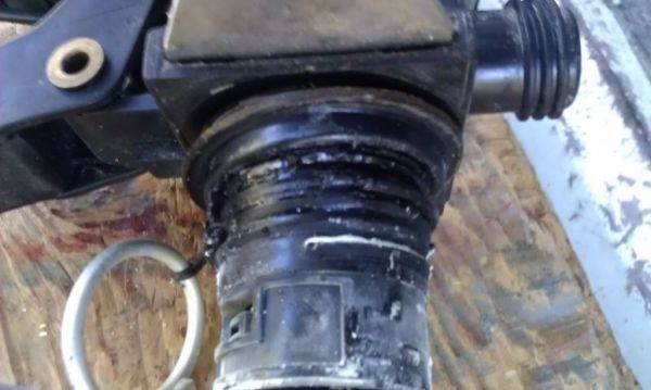

    that and i would suggest buying a commercial grade 5lb abc extinguishers not the 2 1/2 lb kidde fire extinguishers(the small white ones) that most of you guys have now those extinguishers have the internal parts of a kids play toy even the threads on the head of the extinguisher are plastic and have been known to corrode over time and actually blow the head off
    Edit: here is a example of the threads on the extinguishers that holds 195 psi in the shell

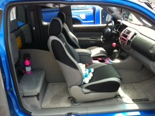

    Even I have one :)...small little pink one in back seat

    Yeah I have the kidde more like kiddy 2.5 pound in the bed of my Tacoma. My work truck has a nice amerex 2.5 pound (supposed to be 5 lbs) in the bed. The kidde one has oily residue near the valve and feels like cheap shit compared to the nice aluminum amerex one. They both see a lot of rough shitty roads and abuse.
