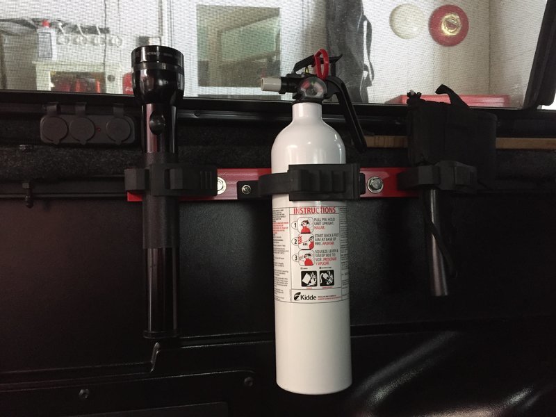

  5. Oct 22, 2016 at 9:44 PM

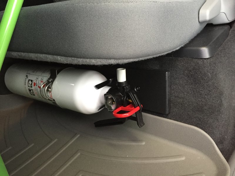

    2011 DCSB TRD OR
    I considered the same thing and when I go to 5 lbs that is how it will have to be. But at the price of these 3 lb BCs I can replace them periodically for quite awhile and still be dollars ahead.
