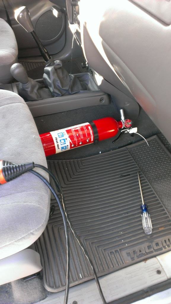

    Yep. You'll notice it sits on the floor so there is no weight load that the bracket has to worry about. Just the strap to keep it in place.

    I have a smaller version extinguisher than the one pictured above installed in my 2001 Double Cab. I put it behind the rear passenger seat. Marked with a sharpie where the bracket would line up so it would sit on the carpet as previously mentioned...
    took the plastic trim off, (had to remove a seat belt bolt)
    Drilled hole
    Used self tappers with drop of loctite.
    *Depending on type of screws used and bracket, counter sinking the holes may aid in the extinguisher being able to sit flush into the bracket.

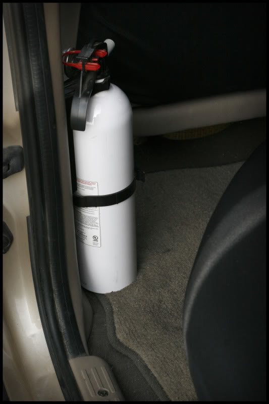

    This is my in-cab install. Have had it for ~5 months and not a single problem with it or passengers being there (the nozzle is pointed down now btw).
    I also have on in the bed when my camper is off (ratchet clamps to a bed anchor) and I will be mounting one to the roof of my camper whenever I have a free day to work something out.
