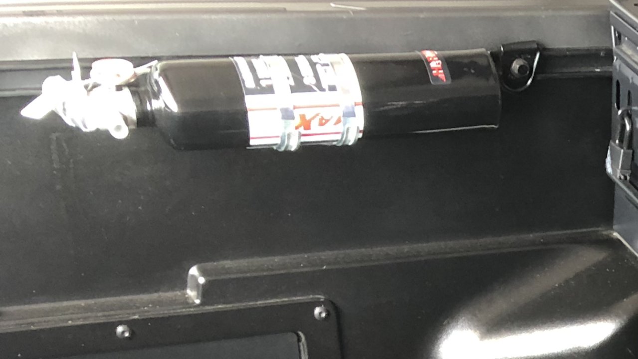

    Here you go, quick release fire extinguisher mount, bolts to the bed rails, no drilling needed. It’ll hold a larger extinguisher, just get bigger hose clamps. It’s a little expensive but works perfect.

    For the same price as the solution above you can have quick fists..
    Super quick fists (need to buy 2), Tacoma bed rail cleats and 3/8 x 16 bolts.
    (Personally I'd just buy the bolts at the local hardware as this price seems high.)
    This solution assumes you're fine with it mounted in the bed. After re-reading your original post it sounds like you're leaning towards in the cab.
