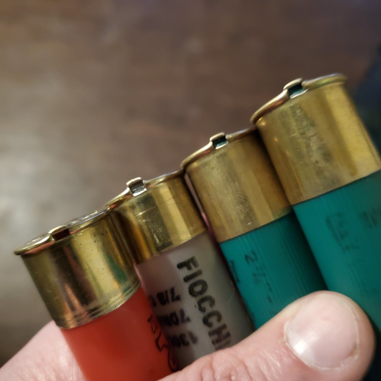

    So I need thoughts from the collective brain trust here
    One of my shotguns has started doing this...it also locks up the action to where I have to slam the butt on the ground to open the pump
    Never had any issues before and owned the shotgun since 2007...happened today with 4 or 5 different brands of ammo
    wilcam47 and montijo505 like this.

    Apologies, it is a pump action and I can't get the bolt to open after it fires
    Benelli Nova 12ga

    The means extraction is getting hard for some reason, look in the chamber for a burr or some other imperfection. Also inspect the outside of the cartridge for any signs it was hanging up somewhere.
