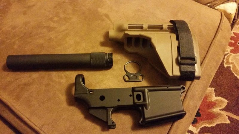

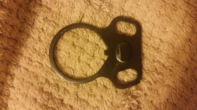

    Hhmmmm. I'm thinking I may need some/all of these as well. I bought a stripped lower, and a second hand used sig brace. It came with a buffer tube, but nothing else besides this piece.

    That's the receiver end plate.

    The buffer tube = receiver extension, and the castle nut may or may not be needed depending on the pistol buffer tube you're using, so you might be ok. If not, the castle nut is a $5 part.

    Is there an easy way to tell? I have no idea what brand the tube is. It looks like the one sig advertises that comes with the brace since it has the part towards the end to stop the brace from sliding too far up. I can hand tighten it all down and then can't move the end plate by hand, if that's good enough

    I'd say watch one of the many assembly videos out there and it will be pretty clear what you need. You don't tighten the buffer tube down, it only threads into the receiver far enough to retain the buffer retaining pin. You should have a castle nut that slides over the buffer tube and acts like a collar to keep the receiver end plate in place, or some other sort of clamp that goes on the outside of the buffer tube.
    If you take a photo of what you have we can tell you if it'll go together or not.
