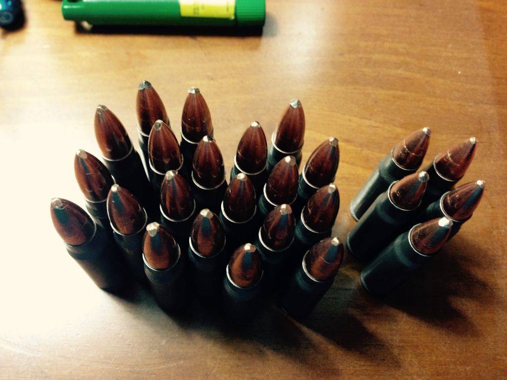

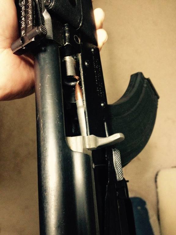

    The tips of the rounds aways smack the bottom of the barrel when loading one in the chamber. I cycled by hand through a full mag 5 times and it jammed twice. Then I cycled through few mags with only 5 rounds in it and a majority of the time it would jam.
    Here is what it is doing to the rounds. The tips are getting deformed and the five rounds on the right are even sunk in a 1/4" from hitting the face of the barrel. Any I ideas as to what's going on or is this normal for ak's?

    Try a bullet guide? It's basically a feed ramp.

    It is my understanding the barrels on these guns are all installed by Century Arms as they are imported as "parts kits". They install AKM barrels with no feed ramps, and as noted above you can install a bullet guide but I have also had some success with a dremel tool. I just cut a very basic ramp to smooth feeding, but it still didn't work for shit with the shorter hollowpoint rounds. Works fine for FMJ though. Either way get some Pmags man!

    Rounds with the bullets pushed in could be dangerous to fire. Some catastrophic failures of glock .40 cals were traced in part to overpressure caused by bullets being pushed in due to repeated unloading and loading.

    i did come across this while doing some research. need to look into it more. thanks guys
    yes mine was built by CAI. they were kind of hit or miss from my understanding. guessing this one was more of a miss :( I've seen some pics where people have used a dremel to make/polish but I'm not thinking this will help me since the bullet needs more height to enter the chamber. i feel removing and metal will make it worse. i will definitely give the pmags a try weather i keep this gun or get rid of it and get another.
    very true. i have about zero confidence in this gun.
    thanks for all the advice guys. I'm currently trying to get my money back for the rifle since the guy that sold it to me said it functions great. he's kind of giving me the run around though :/

    Is it a WASR? If I remember correctly, WASRs were single stack guns which were modified for double stack mags once the SARs dried up. If possible, I'd return it or send it in to CAI.
