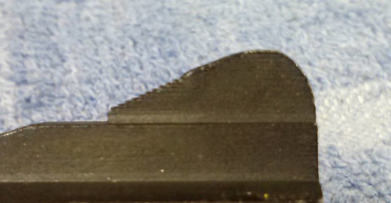

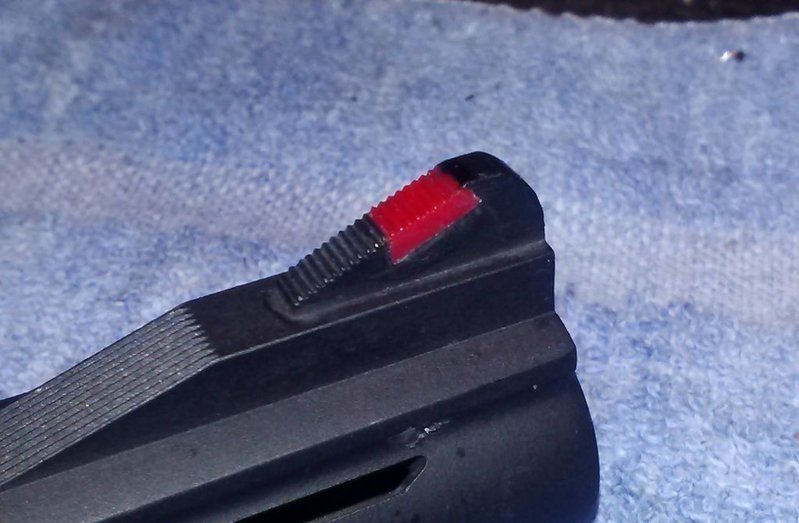

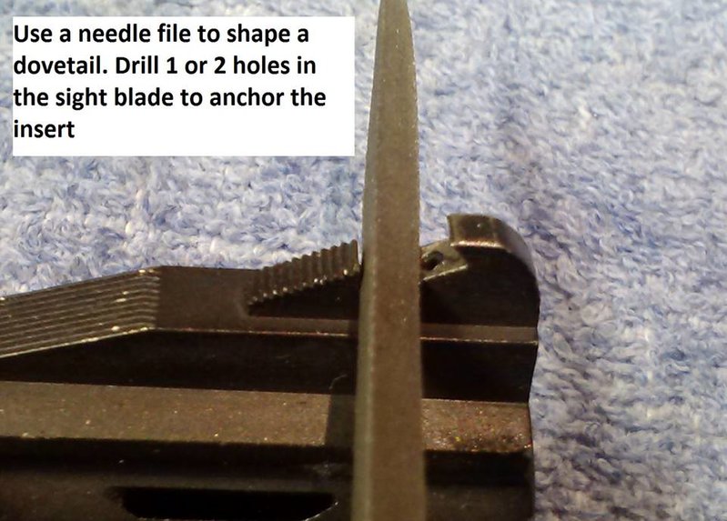

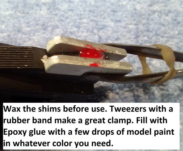

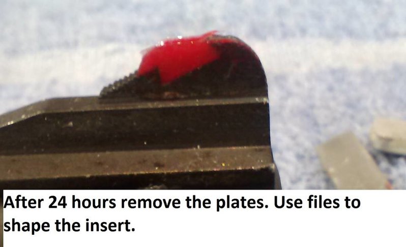

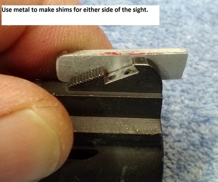

    If you're good with a file you can do it yourself. Here's a little tutorial by the smith I was talking about:

    Thats pretty slick!

    brilliant...may have to nut up and try that

    I suppose you could use glow in the dark paint mixed with the epoxy. If it doesn't work out, just clean it out and refill it with a normal color.

    If your real ballsy you could try something similar and file a vertical flat on it, drill a hole parallel to the barrel and mount a tritium tube in it and you'd have true night sights
