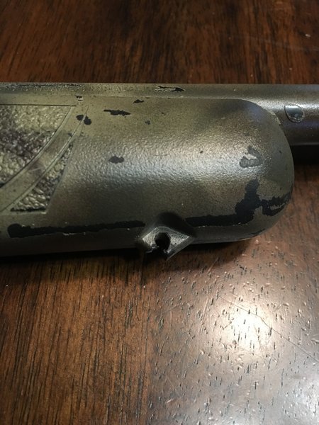

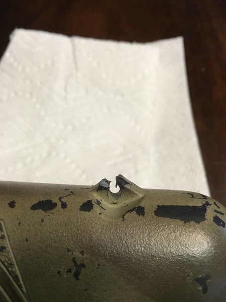

    Went shooting today and managed to break the stock on my marlin XT-22, they made the sling mount out of polymer and they don't hold up to use as a bipod mount.
    Not really sure how to fix it but I'm thinking about using fiberglass bondo to make a smooth fore end and put a picatiny rail section in it's place.

    Probably the best way to fix it is take the action outa the stock drill it out and use a steel swivel, it wouldn't hurt to use some JB weld to lock it all together.

    I talked to some guys on another forum (Quite a few gunsmiths over there) and they recommended an epoxy to build the area to a smooth fore end and then install a stud like so, install the nut in the stock and epoxy in place.
    We'll see how it goes.

    That's what JB Weld is, it's a steel infused epoxy, you can get the it at Lowes or HDepot or any hardware store, Devcon you get through Midway USA or Brownells

    Screw in sling stud

    Looks like a bipod, a lot more torque than a sling. I have done this before. Go back a little, drill a hold for the stud. It needs to be goldilock sized so it wont crack the polymer or wiggle loose. Also needs to be drilled straight or the bipod will be canted. Once that is done sand down the old mount, fill and rattle can.

    Got something better I think, I found a sling stud with a backing plate I can epoxy into the stock.
    Bipod, I love the gun, it's a little tack driver with CCI standard velocity ammo, once I get the sling stud fixed and my suppressor comes in I'll be happy with the gun.
