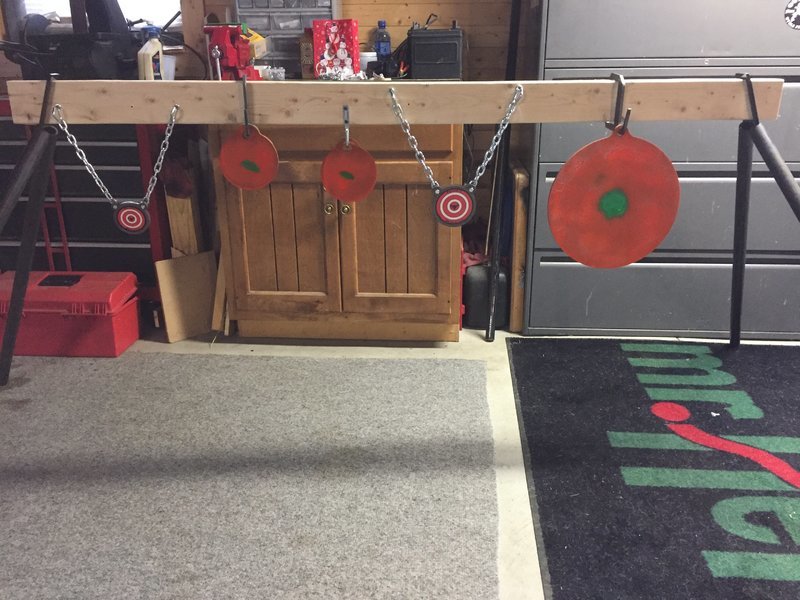

    So - I'm looking to make some DIY collapsible/portable steel pistol & rifle targets. I'm thinking two of each. Before I throw the 60,000 Google Search net, I figured I'd ask here first. I've got a local steel fab shop that willing to make up the actual targets, so that's covered. I'm wanting to see collapsible/portable & preferably lightweight systems for hanging/attaching the steel targets.

    Looks nice. What's the system for the legs?

    The leg are just standard pipe cut to the height I wanted. all other is AR500 steel( except the chains)

    How are they attached to the board?

    You're welcome, with that said. The hook in the middle that looks like a coat hook. I snapped in half hitting the target with my 6.5 Creedmore this past weekend. In the future, I will just get the AR 500 hooks

    Looks good! Are those frames welded?

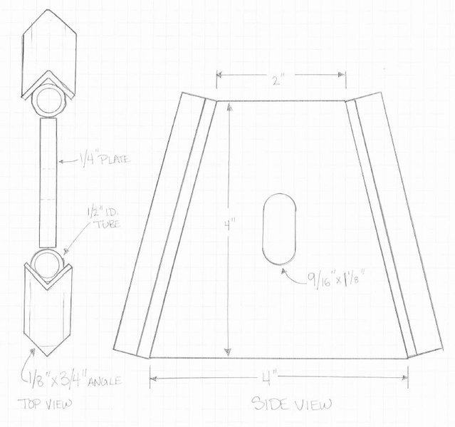

    Agreed, I built a few stands out of wood and they worked but between the splinters and bits of sharp jacket sticking out of them they are no fun to handle. This also of course means that they are only temporary, you can get a number of uses but eventually will have to replace them.
    I have some new stands now that I made up using a few pieces of rebar and a pair of welded steel brackets on the end that hold 2 pieces of rebar together to make a cross piece and then have 2 small sections of tube welded on that I can stick rebar into so that I can adjust height and width just by changing out the lengths of rebar I am using. Works basically the same as the welded ones above but I can break it down nice and small to transport.
    Here is a drawing of the bracket, I don't have any pictures at the moment.
