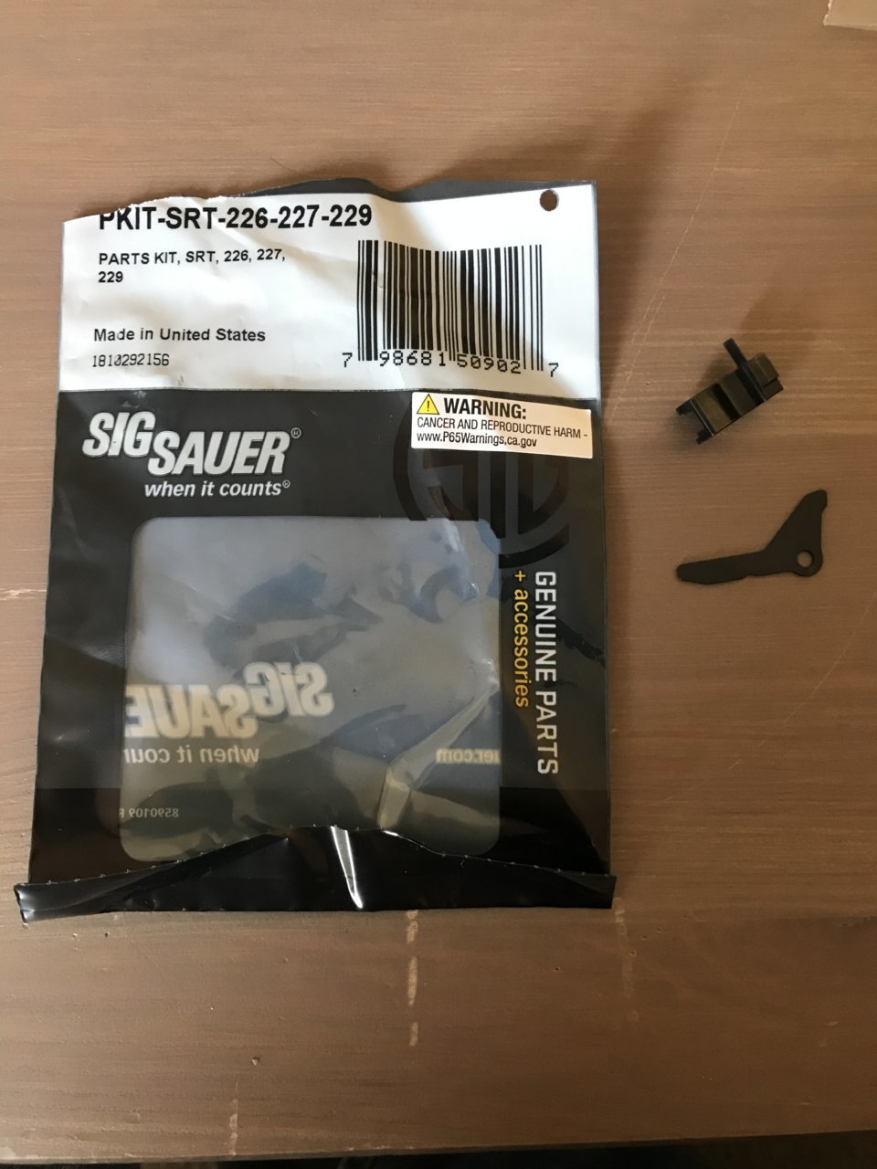

    I’d like to report...the SRT does fit inside the P239 and dry firing seems to work. Much, much shorter reset on the trigger now. Now, to try it out at the range soon. Well, after I get back from leave.

    It’s gonna be a few weeks. But, dry firing it through DA and SA with slide racks it seems to function normally. I have no reason to suspect it will operate differently when loaded and shooting rounds down range
    Took me about 20 minutes to swap out.

    Nope, just a sear and “trigger bar”. Unseated a spring, slid a 1/8” punch through where the pin is to get it out. Replaced the two parts, seated the pin and slid it through with the spring then reseated the spring. It didn’t change the trigger pull, just changes the reset after the first shot.
