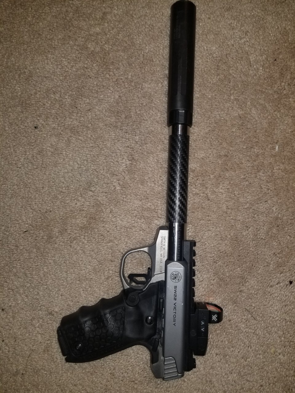

    New hive grip from #tandemkross

    :drool:
    ...I wish

    Looks like an airsoft gun

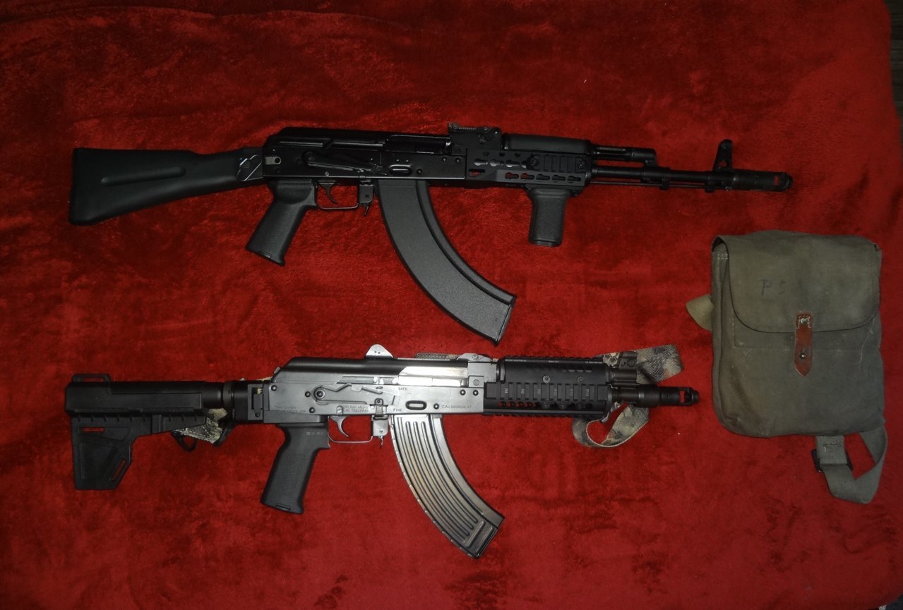

    I only have two AK variants...... Arsenal Arms 7.62X39 AK SLR 107FR and a PAP 92 AK pistol. I do have an IWI Galil pistol in 7.62 x 39 that is the most accurate, most reliable of all the AK's and all run perfectly.
